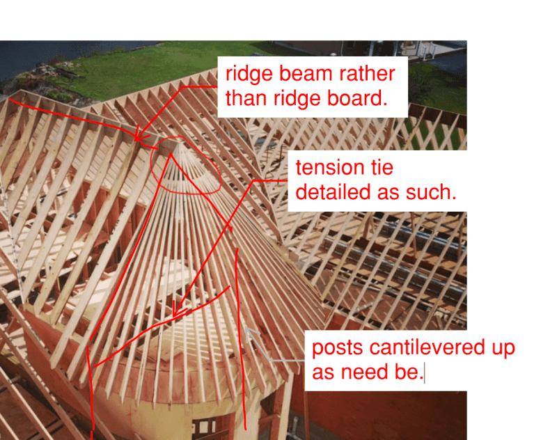

At the turret it looks like there is a floor/ceiling at the bottom of the rafters. If so, that should keep the roof from spreading assuming the rafters are well connected to it. The roof looks really steep, so I would imagine the snow load is small there. Of course it’s hard to tell how long the rafters are.
I’m not sure how I would justify the valley working, but perhaps there’s a way.
I would try to analyze a roof like this by looking at it like trusses in locations where the bottom of the rafters are restrained against thrust.
We had a cool project with a turret roof like this except it was totally cathedral. We used a steel tension ring at the base to resist the outward thrust.
I feel as though the floor might be a little lower than the rafter bearings but it's difficult tell from the photo without staring at it for 30 min.
Were this mine to have done, I'd probably handle it as shown below.

The thing might also benefit from some nifty, semi-circular hoop stress action to help prop the ridge board. Drag it back to the adjacent shear walls. That said:
1) I don't think for a second that this would have been an intentional aspect of the design.
2) The strategy would be riddled with potential, and likely, detailing fails. Starting with tension continuity in the curved top plate.
