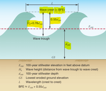

In Chapter 5 of ASCE 7, equation 5.4-3 has the stillwater depth elevation, Ds as:
Ds = 0.65(BFE - G)
However, the Coastal Construction Manual has it as:
Ds = (BFE - G).
Does anyone the origin of the 0.65 factor? It makes a BIG difference in calculating the breaking wave on vertical walls.

My understanding is that this is from the definitions used. ASCE 7 use BFE which includes wave height and the Coastal Construction Manual uses design stillwater flood elevation. Its six of one or half dozen of the other. Best to pick a methodology and stick to it.

FEMA Coastal Construction Manual Equation 8.1 said:
d[sub]s[/sub] = E[sub]sw[/sub] - GS
where:
d[sub]s[/sub] = design still water flood depth (ft)
E[sub]sw[/sub] = design still water flood elevation in ft above datum
GS = lowest eroded ground elevation, in ft above datum, adjacent to a building, excluding effects of localized scour around the foundation
So it isn't BFE - GS. That's an important difference. As you can see from GC_Hopi's post as well as ASCE 7-16 Figure 5.4-1, E[sub]sw[/sub] is generally taken to be 0.65*BFE. So the results are equivalent. Keep in mind, however, that many jurisdictions will not let you design to BFE. Where I am in the Mid-Atlantic, each municipality can set their own minimum freeboard in the local flood ordinance. Most are 3ft. So I would use this equation:
d[sub]s[/sub] = (DFE/BFE)*E[sub]sw[/sub] - GS
where DFE = Design Flood Elevation (BFE + Required Freeboard)

So, as I see it, using ASCE 7-16, ds=0.65(18.2-12)= 4.03 ft.
Another engineer doing the peer review, says I'm incorrect and ds=(18.2-12)=6.20 feet.
Who is right?
As I understand your posts, I should be right. Am I missing something?

I would check with the DEP. See if their DFE is based on still water depth or wave crest. If wave crest, you're right. If still water depth, the reviewer is right.
These both assume that your erroded ground surface is the same as the top of your grade beam.
