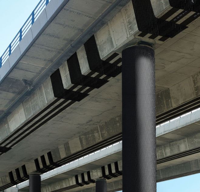

I don't know what the budget is, but that might be a scenario for a specialist engineer and some FRP Wrap.
I don't think it is cheap, but they can do some really cool stuff.

That concrete structure doesn't look like it has suffered from deterioration. Do you know why the FRP wrap was added? Inadequate design or unanticipated increase in loading?
That's just a repair photo I found on the internet. I was trying to find a photo where they did both flexural and shear reinforcement.

For a deteriorated beam, I would think that you would need to shore it somehow; then build back up the deteriorated concrete with a repair mortar.
Then, an FRP wrap could be installed and the shoring removed.
It's complicated stuff though. Aside from the FRP itself, you would get two interfaces that would require calculations. The interface between the repair mortar and the beam; and then the interface between the repair mortar and the FRP sheets.
I took a class in the stuff. It's awesome, but definitely a niche market requiring expertise.
Hokie66, that image is photoshopped.
Tom - I think you might be correct. Now that I look at the bridge photo; it does look a little strange or manipulated.
I apologize, I did not notice that last night. (I had my 2nd Covid shot yesterday and was out of it all afternoon/evening)
