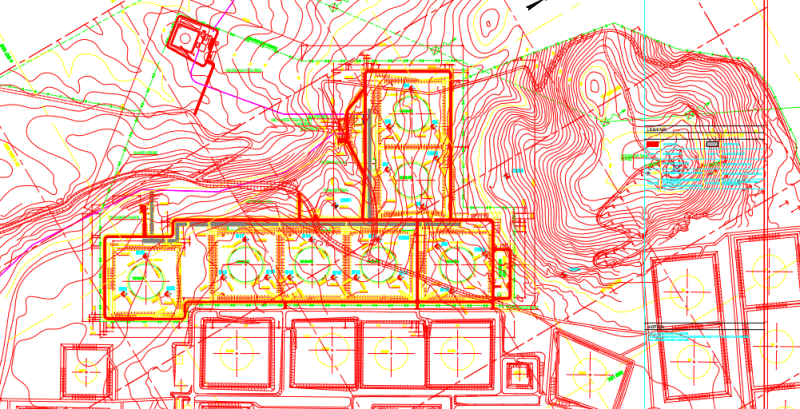

Check it out on Google Earth
36°53'45.66"N
35°55'17.06"E
[highlight #CE5C00]100m Diameter Tanks[/highlight][highlight #EF2929][/highlight]
6.2.1 Geo-technical conditions
As part of the soil investigation studies that have been previously performed, a total of 6 borings have been made on site and the samples revealed that the top layer of the soil consists of sandy / gravelly clay with a layer thickness up to approximately 6 m.
Under this layer are located layers of vesicular basalt and basaltic breccia.
Tests made on the samples have shown that the vesicular basalt and the basaltic breccia layers consist of highly to moderately weathered material.
Uniaxial compressive tests on the samples have shown various degree of strength, ranging from 48 MPa to 278 MPa for the vesicular basalt and from 10 MPa to 38 MPa for the basaltic breccia.
The previously performed TCR and RQD test results, have shown the vesicular basalt and the basaltic breccia as highly to moderately weathered.
Also the previously performed pressure meter test results have shown a modulus of deformation of minimum 16 MPa for basaltic breccia and minimum 56 MPa for vesicular basalt. These values can be used for estimating the settlement of the tanks.
The soil pressure under the tank, derived from the height of the liquid column and weight of the tank is 0.20 – 0.22 MPa maximum.
These values are far less than the uniaxial compressive strength values of the rocky sub grade and therefore the bearing capacity of the vesicular basalt and the basaltic breccias layers of the sub grade is sufficient.
Soil characteristics of the top layer of sandy / gravelly clay are not determined. These values shall be obtained by tests during detail design.
In order to obtain a sufficient bearing capacity for this top layer, compaction to 90% of the Proctor value is required.
The borings shall be drilled with rotary type machines equipped with a hydraulic feed or hollow stem auger type drilling equipment and capable of securing satisfactory samples of the required diameters to a[highlight #EF2929] depth of maximum 60 meters[/highlight]. Casing shall be used where necessary to keep the hole open and enable the boring to advance. When bedrock is encountered during the drilling process, rock shall be cored to a depth of 3 m to confirm soundness of the rock. If rock is sound no further drilling is required.

"Its OTT" - thats the main issue in geotechnical engineering. Projects with tanks of up to 100mm id dia are probably turning over millions-billions of (insert currency) a year. The budget cant take another 20k to drill a deep borehole??
If youre happy to take the risk and go to half D then go for it but I would not be happy to do that. A 100m tank has a zone of influence of approx 1.5-2B so 150 to 200m. A settlement calc needs parameters to at least 150m-200m. You are making assumptions below 60m at your own peril.
Ive been there before and reluctantly made those assumptions but not after I have first highlighted that we want a borehole to 2B.
Edit 1 - I agree with a shallower borehole if you are confident your in continuous rock.
Edit 2 - I noticed in my earlier post that I said 120m for a 50ft tank. That was an error, should have said 2B so 100ft!
EireChch, Thanks for addressing my concern. I was thinking about smaller tanks as well (100ft), when I mentioned 20m, so it is true that I might be pushed to accept a 1D boring depth, if there was sufficient reason to justify deeper borings. I also point out that the 60m depth there was not conditional with finding rock. As those are about the largest tanks, both in diameter and height, you will ever find and the area is subject to severe earthquakes, there was probably considerable risk, yet they did not recommend deeper bores. The tank's liquid load alone when full is also around 4000 psf, with additional 20m shell load on the rings, so tank loads just don't get much higher than that. The tanks have been there for 15yrs, so fortunately they seem to be performing well.

Yes I 100% believe that 60m deep borehole is totally inadequate for a 100m dia tank. One borehole should be taken to at least 1.5B.
Just because you "got away it" doesnt mean its justifiable. If you are in granular soils then the risk is greatly reduced. However when you get into CLAY, even if its OC CLAY, the settlements add up. Secondary compression in OC CLAY, although quite minimal will still add up if you have sufficient thickness of it.
