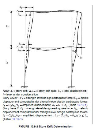

The following excerpt from ASCE 7 -16 showing the story drift ratio
The story drift ratios may also be used for stiffness irregularity check. ( Soft Story Irregularities Types 1a and 1b).

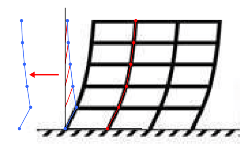

I can't see the model very well, but the bases look pinned. If they are, and if the moment frame columns and beams are the same at the various levels, then I would expect the drift ratio to be a lot higher at the bottom story than the stories above.
As HTURKAK pointed out, your plot is of the drift ratio and not the displacement. Frame drift is typically dominated by shear, so for your pinned base structure the largest drifts will generally occur at the lower levels and decrease as you move up the building. See below for an example illustrating the difference between a plot of the displacement (red) and a plot of the drift (blue).
Since you have a tall first story, the drift at the lower level is exaggerated. Be sure to check for a soft story irregularity.
