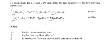

Hi. I am doing a project for calculation of steel metal grating. I have to do strength analysis of steel metal grating having uniformly distributed load of 400kg/m2 and point load of 80 kg. Which eurocode standards i should follow apart from 1993-1-1 for finding appropriate load factors for this case. I will do my analysis on workbench.

You are expected to look EN 1990 Eurocode. Basis of structural design. Typical comb. and load factors are
1.35Gk + 1.5Qk
You can download old versions free of charge , since law resource.

Thank you for your response i can not find 1.35Gk + 1.5Qk in eurocode 1990. Can you give the chapter number in which i can look for these values and what its for

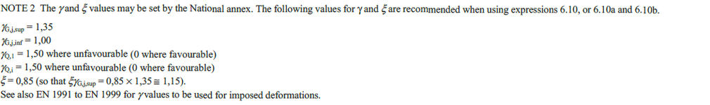

Pls look EQ (6.10a)
And Normative Table A1.2(A) - Design values of actions
In case of accidental actions the load factors are different.
The factors in 1990 may vary in the various national annexes, probably not critical for OPs grating, but in Norway it's:
6.10 a: 1.35 x DL + 1.05/0.9 x LLs, or
6.10b: 1.35 x 0.89 + 1.5 x LL (main) + 1.05/0.9 x LL (other) for STR combinations.

Pls look EQ (6.10a)

The steel metal grating will be used in livestock industry so using eurocode 1990 standard will be ok?
