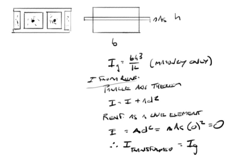

Masonry behaves similarly to concrete in that once it is cracked you cross from elastic design to plastic design, for deflection this means you can no longer simply use the gross moment of inertia, ie b*h^3/12 for a solid grouted wall (note you could use the transformed section here accounting for the reinf. but a single bar in the middle of the wall won't add anything), but must now use an effective moment of inertia or the cracked moment of inertia, this is the point where the reinforcement will impact the deflection.

So for a solid grouted wall with reinforcement at mid depth and a loading such that M < M,crack:
