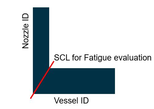

Thanks NRP99 for the reference on report requirements, I will check into that. On the topic of fatigue - this is indeed a report on fatigue life, and these oddball SCLs are driving the life. In this case of fatigue evaluation, how do these types of SCLs come into play?

For fatigue life evaluation the SCL should be across the corner and not like the shown in your latest plot, which I should have told earlier. Like the image below-
The SCL at this location is used to identify the peak stress value and this stress value used for the calculation of stress range ΔS[sub]p,k[/sub] and hence fatigue life.

22west - the SCL that you drew in your latest sketch is 100% not a valid class line, and would likely pass none of the validation criteria. I have never, in my career, seen a SCL so bad. It truly makes me question that entire capability of your consultant. If you were to submit this to TSSA (I see that you’re from Ontario), I am confident that they would reject this.
For starters, why are they generating a SCL for a fatigue analysis? Are they trying to claim that there is a Ke factor greater than 1.0? I sure hope not based on that horrific SCL.
And NPR99 - your SCL is almost equally as bad. It would not be considered a valid class line in the context of VIII-2 and would most certainly fail any validation criteria.

This SCL line location has reference in ASME PTB-3. May be, explanation is not clear in post but the intention is clear-to use for fatigue evaluation.

NPR99 - exactly which example in PTB-3? I’ll bring it up with the authors and have that fixed the next time PTB-3 is revised.
Just so everyone remembers, PTB-3 dates from 2013. The Code has changed since then and engineers need to make sure that we’re using the current edition and not an example manual that references a code that is 10 years old.
ASME VIII-2 2021, Figure 5-A.3 (b), also shows a similar SCL. While I understand this is an example of orientation relative to stress distribution only, it isn't clear that this is the case, and probably shouldn't be used as an example when it isn't a valid SCL placement.
