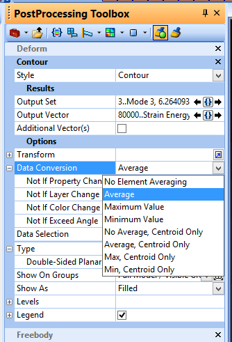

If I consider one of those elements and I plot in Femap the model and the f06 ,the stress in the 'active stress response list' is different from the one in the final static analysis.

Femap have different methods for data averaging. Try to set "Data Conversion" to "No Element averaging" or other option.
Hi, thank you for the reply.
I've change the options but this is not the problem.
