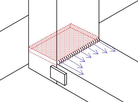

Lets say you have the set up in the diagram, with a HSS rectangular tube welded against another tube at a 90 degree angle. The connections to that vertical tube are irrelevant because I'm only concerned about this one joint. There is a cantilevered load on the end, and assume those two straps connect the tubes and are also welded all the way around. Now, if you ignore the straps it seems relatively straightforward in computing the max. stress of the weld joining the tubes. You simply look up the Iu for that particular weld group (whether its welded all the way around, 3 sides, etc.) then compute I = .707*h*Iu. Then Mc/I for bending stress and V/A for shear stress and use the Pythagorean theorem to find the max stress.
My question is, if you added those two straps on the sides to reinforce this joint, how would you go about calculating the contribution of those weld groups? How would you find the maximum stress? Can you just calculate the "I" value for the welds around the straps and add it to the value discussed above? I guess its throwing me off because for all the examples I find, they only examine one, continuous weld grouping, nothing like this. Thanks for any input.

Whether or not you ignore the straps, you cannot assume uniform stress in the weld across the wall of the vertical HSS because the wall will bend, resulting in lower stress in the central region and higher stress near the ends of the weld. A reinforcing plate inside the vertical HSS would help to alleviate that condition.

All the usual Mc/I solutions assume rigidity all over the place. As BA pointed out, you really do not have that rigidity at the tube to tube welds. So some valid approaches for ultimate strength, in order of my preference, include:
1) Put everything in the tube to tube welds and account for the flexibility there.
2) Put everything in the side plare welds.
3) Improve the connection to make one of the above pan out.
4) Do something expensive like like FEM to realistically asses how much force goes where.
If it's possible to do so, I think that your side plate connection would be greatly improved by running the horizontal member through the joint, beneath the vertical member.

What BAretired is referring is that regardless of if/how the vertical HSS butts against a fixed tube at the back, the tensile force that exists in the top 'wall' of the horizontal HSS must be locally transferred to the face of the 'wall' of the vertical HSS (via weld), to complete the load path. BUT, the outer face of the 'wall' of the vertical HSS will deflect/distort and hence the distribution of tensile forces across the face will be non-uniform (BLUE arrows), hence why BAretired recommended a reinforcing plate, positioned as shown in RED below:

I might be wrong about this but I am wondering if the blue/red diagram is incorrect.
I understand that the wall of the tube might (otherwise) bend BUT... doesn't the top of the horizontal tube act to stiffen the wall of the vertical tube?

In my world, I would take the canti. moment with the two horiz. welds, t&b, pretty straight forward fillet welds or PJP welds. BA’s advice (30DEC16, 23:00 post) and Ingenuity’s sketch (31DEC16, 4:14 post) are pretty straight forward and important to understand. The bulging of the wall of the vert. HSS as it is loaded is important to understand, as it transfers some of its load, from mid member, out to the sides of the joint, due to its flexibility. I would make the two vert. welds take the shear loads, although these two welds are nasty flare-bevel-groove welds btwn. the end of the horiz. canti. and the round corners of the vert. HSS. These welds are really difficult to do well, and doubly so where they transition into the t&b horiz. welds. At these four corner locations the stresses in the welds are a max. and the potential for inferior welds and defects are at their max. too. That being said, I would now make my straps differently than yours, to protect against these high stress areas and potential stress raisers, etc. I want to make my straps transfer the loads from the webs of the horiz. canti. member into the webs of the vert. member. I would make my straps “L” shaped plates, 6" +/- out onto the horiz. member and 6" +/- up onto the vert. member, with generous radiuses on all of the corners. These plates should be a little narrower in width than the side dimensions of the HSS members so they can be welded to the HSS members with a continuos fillet weld to the sides of the HSS members right at (near) the tangent points of the corner radiuses of the HSS corners. I would design these “L” shaped straps to take a good share of the moment at that joint, that is, the outer 2/3rds. of each leg of the “L”would react against the moment. That’s a bit of belt and suspenders. but conservative. We really don’t know exactly how to design any finer, in detail, than that, because we have no easy way to account for the stress raisers and potential fairly natural/common defects at the max. stress regions of the joint. From the load path, stress flow standpoint, you might be better off if you made that 90̊ corner from a solid block of steel, where the vert. HSS member and the horiz. HSS member each butted into the solid steel block with CPJ butt welds to the solid block, you would likely have more confidence in the weld quality, particularly at the corners.

You don't. At least not without resorting fancier methods such as FEM etc as I mentioned previously. The issue at play here is:
1) You've got two distinctly different load resisting mechanisms at play here (HSS/HSS welds and reinforcing plate welds).
2) Your two load resisting mechanisms are of different stiffness. The reinforcing plate path will likely be the stiffer of the two.
3) Since welds are, in general, considered non-ductile, you can't yield one of your mechanisms and hope to retain it's capacity until the more flexible method kicks in additively.
Were I a betting man, I would guess that your reinforcing plate welds and the bits of HSS/HSS weld nearest the corners will draw the lion's share of the load initially with the HSS/HSS welds between corners doing relatively little. Then the reinforcing plate and corner welds would rupture and load would redistribute to the HSS/HSS welds between the corners. Unfortunately, those welds probably aren't strong enough to do the job on their own so they, too, can be expected to fail. And that leaves you with no capacity.
In various AISC documents, there is some precedent for designing welds for 1.25 times the anticipated stress when there is uncertainty regarding stress distribution. You could do something like that here but, in many respects, that's still a crap shoot.

If it were me, I'd run the horizontal piece through, use the larger reinforcing plate and weld groups that would facilitate, and make the reinforcing plate load resisting mechanism take 100% of the load in the joint on it's own. Short of not reinforcing at all, I think that this would be the cheapest alternative to fabricate. You wouldn't even need to bother with the HSS/HSS welds unless there were a non-structural reason to do so (corrosion / aesthetics).
