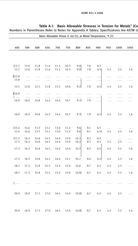

Stress value in table s301.3.1
AliGrailly
Dec 8, 2020
72
plz see the Table S301.3.1 Generic Pipe Stress Model Input ( b31.3 ) it gives the stress value of material ( A106-B ) at 288 degree = 18.1 ksi or 125 mpa , based on interapolation from table A-1 or A-1M :
500 F 600 F
19 ksi 17.9ksi
result : ~18.45 ksi / 127mpa
what s wrong?
different value edition 2008 and 2014 ( previous picture ) ???
Stress value in tension
500 F 550 F 600 F
18.9 ksi 18.1 ksi 17.3 ksi
Screenshot_%DB%B2%DB%B0%DB%B2%DB%B2-%DB%B1%DB%B1-%DB%B1%DB%B6-%DB%B2%DB%B2-%DB%B5%DB%B5-%DB%B1%DB%B3_y0uhmi.png
More advanced stress calculation instruments have been used. The differences are very minor though.
