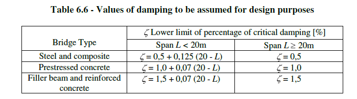

Hi all,
I am trying to get my head around the BS EN 1991-2:2003 - Part 2: Traffic Loads on Bridges.
I am struggling on within being able to find the structural damping (δ) needed in figure NA.9.
I have found that it is safe to assume 2% for a fully welded bridge/truss.
What I cannot find is what percentage is safe to assume if the structure features pinned connections or how to calculate it.
Any direction on where or how to solve this would be much appreciated.
Thanks!!
Well, logarithmic decrement is a really easy way to determine damping when you have a measured response over time.
I could not see why you are struggling.. Figure NA.9 is for Reduction factor, δ , to allow for the unsynchronized
combination of pedestrian actions within groups and crowds . You are expected to look for Structural damping – logarithmic decrement, δ to Table 6.6 , Values of damping to be assumed for design purposes.

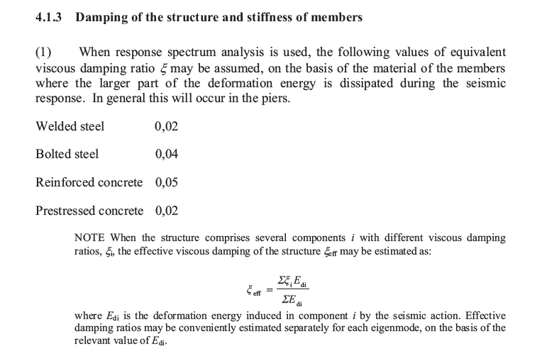

FYI Damping ratio values for elastic analysis of bridges for seismic ;
- Welded steel: ξ = 0,02
- Bolted steel: ξ = 0,04 ( in general ) but you may use for high resistance bolts 0,03 and for ordinary bolts 0,05
- Prestressed concrete: ξ = (no cracks) 0,04
- Reinforced concrete : ξ = 0,05 and with cracks 0,10.

Just for clarification i added the excerpt from Eurocode 1: Actions on structures ,Part 2: Traffic loads on bridges
and the excerpt from Eurocode 8 — Design of structures for earthquake resistance — Part 2: Bridges
Notice that the damping for traffic loading is in general related with superstructure while for seismic damping, the pier damping governs ( but second order effects may occur in arch and cable stayed bridges )

In this case , if the span is greater than 20 m, ξ =0,5 % =0.005.
I hope ,this clarification will be answer to your thread.
