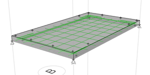

I'm playing around with a simple 7'x12' slab in SAFE, with pin supports at the corners and I am finding that SAFE still wants me to provide top steel. If this slab is truly pinned, for instance formed onto some sort of angle or support with minimal moment restraint and moreso just shear studs to keep it from sliding, how come I am getting negative bending? The supports are currently placed directly at the corner, so it's not like the moment is being generated over top of the support.
I'm not sure if maybe since the pin support is placed at the datum, which coincides with top of slab it is taking the slab as being supported by the top? I tried shifting my supports down by my slab thickness but it throws ill conditioned warnings.

can you show just an image of your model in 3d with the support turned on, do you have single pin, ux uy uz restraint, defined at each corner or are there short wall segments in each direction not clear from your reinf. heatmap?
If you have true pins at all four corners then you will get a small region of tension near the pin
If you have true pins and they are offset to the top or bottom slab surface then the end rotation will be partially restrained and you will get a larger region of negative moment.

Here is the render:
Pin supports are at top of slab, I tried offsetting them by the slab thickness to the bottom, but it made the model ill-conditioned.

Yea I found the setting in the shell element to make it have the datum at the bottom, so the slab is supported at the bottom as shown in the screenshot below:
However, my contour diagrams for negative bending still have negative. I've seen other stamped drawings with this exact reinforcing (no top steel) so obviously I am missing something. Or they just did it by hand assuming simply supported and went on with their lives. I mean concrete will perform to how it is reinforced anyways, might just get some microcracks at the top at the corners then.

moving the supports to the bottom of the slab creates the same cross section rotation restraint that supports at the top of the slab create, try setting the support elevation to the slab mid depth.
Even at mid depth though you will still get some negative bending moment in the corners I believe the primary source may be twisting moment (Mxy) and some other contribution from the inherent error of being finite elements.
