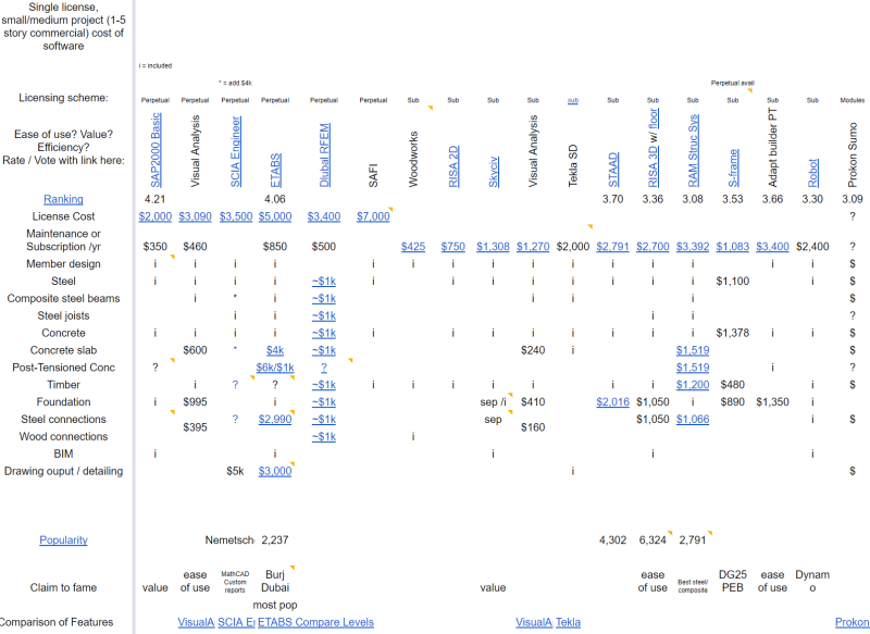

I'm starting my own firm, I'm familiar in my career with RAM and RISA mostly and wanted to see what else was out there. I created a spreadsheet for my use to compare suites and wanted to share with anyone looking into this as well. I've favored the perpetual stand alone licenses, but have included the subscription models as well, mostly ordered by cost.
I'm leaning toward getting ETABS for many reasons after a month trial, still kind of on the fence as I'd love to have something that does a good job with timber as well, but it's a great value and I can probably 'fake' it to do timber. It's just so good with concrete and steel and I can add-on with 3rd party software and expand with SAFE for concrete floors, Detailer for autocad output, ideastatica for steel connections, and add-ons for irregularity checks and column design among others.
Many thanks to those who have contributed to discussions on this extensively before, every software has it's own pitfalls and it's helpful to know these. I know there are a lot of discussions out there on this, and I've read quite a few of them. I think it's the more the merrier for those out looking for a good value.
I'm welcoming your input especially in 3 areas
[ul]
[li]Helping to complete the info listed (limited / incomplete info)[/li]
[li]I'd invite you to review software that you know in it's title link within the spreadsheet to 'alternativeto.com', this is where I've found some really good info on other types of software, and the structural software is left woefully unreviewed.[/li]
[li]Discuss if you think of a better value than ETABS for perpetual single license for small/medium project (1-5 story commercial)[/li]
[/ul]
Here's the link and a screenshot, this is editable to anyone
[URL unfurl="true"]https://docs.google.com/spreadsheets/d/1bM4KqEZNylKiGzjId4fp5i5VXSRIUzQm6Wb7VBSWYVA/edit?usp=sharing[/url]
Edit: Updated screenshot, orig above kept for context

You'd probably be fine with visual analysis full design.
Very detailed analysis, nice.
I would personally forget cost and just go with whichever one you want. it will all be a wash over time.

Jonster, thank you for this list, I have always wondered how much these software packages cost.
NorthCivil's list looks really good, forget about the technical stuff and go with the software you know the best and feel most comfortable with.
Nothing on that list jumps out as outrageous in my opinion.
A few notes:
- What in the world is this ranking list you found? I would not put much credibility into this if I were you. The software package you know best is the best software package for you in my opinion.​
- Why is Tekla so much? Is that Tekla for structural detailing or Tekla structural designer? For what it's worth, I absolutely despised Tekla Structural Designer​
- Robot is pretty expensive for what little market it feels like it has in my neck of the woods.​
- I had no idea ETABs was a perpetual license, I might purchase a license myself if I can scrounger up enough cash​
- RAM concept at $1519 looks like a steal if you do lots of concrete slab design, seems crazy that ETABs is at 6k for PT​

Kipfoot, Thank you for the suggestion, it’s worth considering VA standalone full design for the cheaper $3k than I had listed for their $5k 'construction package'. It looks similar to using Risa and useful for smaller tasks even if I get another design package in the future (ETABS is awkward for member design, google how they have you define 'design lists' vs VA and Risa let you define sizing rules). I’m looking forward to starting a trial with VA and think I will hold off getting ETABS for now.
NorthCivil, That is great advice as well, it's said 'penny wise pound foolish' for the time I would waste wrestling with a 'cheaper' software. I still haven't tried visual analysis in a trial yet, and this may end up being the best way to go for now, and perhaps if I start to do a great deal of concrete design in the future I can get ETABS and be really productive.
Sticks and triangles, the ranking list was found in a study done to survey hundreds of Structural Engineers if I'm remembering right, it is found in the Link here and in the spreadsheet. Tekla hides their software cost so I don't know how much it really costs, so if somebody has a better figure please update the spreadsheet for us. if you really despised their software that's enough for me to not consider it in the future. and bear in mind SAFE for ETABS is 6k for a Perpetual license, and concept is charging $1519 just to rent each year. concept really is a great piece of software and $1519 would be a great deal if it could be stand alone without needing to also have Ram. I have experience with RAM's API and it was powerful at times to have access to that, ETABS' API really opens up options for add-ons to purchase I've found.

One other package that may be worth your research time is SCIA, Link, I demo'd it a few years ago and it was very powerful on the analysis side but it's design modules where still very much in their infancy relative to our North American market.
SCIA looks fantastic from this review which also states pricing starts at $3,029 so it's comparable with the cheaper perpetual offerings listed in the spreadsheet.
It looks like it has advanced connection design built in and an excel / mathcad like functionality for custom reports, do you think that this could help make up for the design module shortcomings? Does anyone know where their US design capabilities stand now? But yes, very interesting, thank you for the heads up!
It looks like they support IBC 2012, ASCE 7, AISC 360, ACI 318, AISI 2007, SJI 43rd based on this link [URL unfurl="true"]https://resources.scia.net/en/articles/codes/5.american_code.htm[/url]
If their design modules catch up I may preview SCIA as well once I'm looking for a more serious design package
Edit: From sales, FYI
I got a quote for Tekla a few months ago. For Tekla Structural Designer, it's $2k/year, Tedds is $1k/year, and the TSD Suite (TSD and Tedds) is bundled at $2500/year. Tedss comes with TSD LT, which has full TSD functionality but is limited to 200 members per model.
This does NOT include Tekla Structures, which is a BIM tool and more useful for fabricators. I'm not aware of any analysis features in it.
