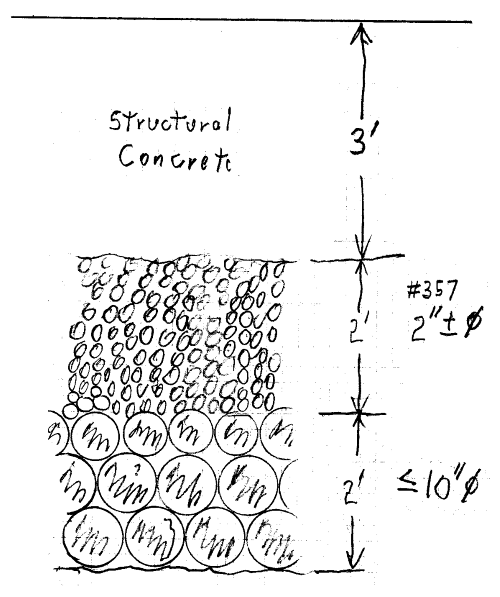

bootlegend - When considering a solution to an unusual problem, to me, even the crude approximation of a picture is worth a thousand words. Here is my grossly simplified view of the proposed solution:
Does that concept look like the kind of fill I would want under a structural slab (even though the fill and the slab are confined on the bottom and all sides)?
IMHO, no, to many possible voids. I would go with smaller stone backfill.

Your sketch is a pretty good approximation of my proposal. Wouldn't most of the upper voids be filled while compacting the upper layer? Wouldn't this prevent the migration of the upper material into the lower voids? I'm not sure so I'm asking the question

bootlegend - Voids need to be minimized for full depth... not just the upper layer. Even the #357 stone will have too many voids, IMHO. If there are voids, over time the compacted fill can "ravel" to voids below. Somewhat like a sinkhole.
I like the suggestion the other engineer suggested to you:
...4" to 6" max size but use crusher run for the whole depth so you get the small and large stuff together.
Well mixed "large" and "small" aggregate... just like concrete without the cement.
A little more about my sketch. I used approximate 10" spheres, the best case. Spheres can be "arranged" for for minimum voids by using "cubic closest packing". For this arrangement, there are (theoretically) 26% voids... unacceptably high, and no amount of compaction will make it better (unless the rock is broken). In real practice, voids will be much higher. As a former bridge contractor, we had projects that included hand placement of "one-man rip-rap" (equivalent to the 10" size proposed,supplied directly by a quarry). From the quarry, rip-rap is not spheres... not even close. Even with careful hand positioning, I'd be willing to bet voids were about 50%.
