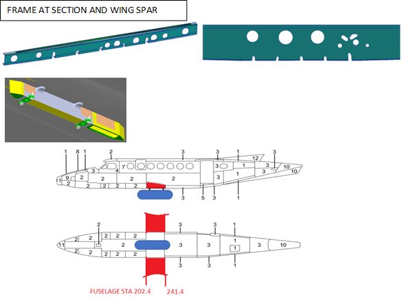

Hello,
I am working for a small company installing equipment on a FAR 23 aircraft fuselage. The installation includes antenna and external pod affecting the fuselage skin stringers and frames. Since we have no access to the OME stress reports, internal loads, external loads, I wonder what design and analysis approach I can use to ensure compliance and FAR 23 STC certification

I am now in preparation of a plan to be presented to our local certification authority (like FAA). The issue of cutting small penetrations for antennae and hardpoints for external equipment attachments involving skin and stringers seems not too complicated as SRM solution could be implemented using higher than skin gage doublers to restore limit and ultimate load capabilities. The issue I am facing is with the hardpoints supported by intercostals connected to adjacent frames. Unknowing the frame stress level and strength capability, I am adding loads impacting the frames locally. Any idea how to strengthen the frames at the attachment? I am planning to add a frame, back to back, with the existing ones with capability to carry the additional loads, ignoring the existing ones. The issue is how far to go with the new frame.
Please help with any idea.
Hi Ashco, to clear up and ambiguity about the structural mod youre proposing, could you provide a sketch of the hardpoint, intercostal, frames, and back-to-back frame segments? Are the intercostals new or existing?

The project is a mod of King Air 350. We are still in negotiations with the certification authority on which amendment to be included. We are trying to do to the original one (9 g crash landing required vs 18 g recent amendment). This is a preliminary evaluation to prepare a certification plan to present to our authority for review so I am not yet sure which approach to use. One option (the costly one) is to prepare full external and internal loads and to modify existing structure accordingly. The second is to propose a structure conservative mod that adds modifications assuming all added loads carried by newly added parts. Since my background consists of working only with OME’s where information is available, I am not sure what approach to follow in my tiny organization.
As the installation area of the pylon is in fuselage/wing common area, this further complicates the matter. The section is under the cabin floor, cramped with systems (control and electric cables, pipes etc.), design planning not to remove system. It requires designing parts mate of several pieces and assembling them in place.
I am adding some pictures hoping to answer some of your questions.

King Air is part 25, no? 18g crash landing ?? That may be as a dynamic load, as opposed to the static 9g
Indeed, checking 25.561 (current) tells me this, that current crash case is 9g fwd.
Where are you seeing 18g ?
Having looked at your pic, why crash landing loads ? 25.561 applies to items of mass within the cabin.
Your pylon is going to be affected by "wheels up" landing and ditching.

Why didn't you post your diagram?
Not knowing if it's a typo or you honestly believe in your acronyms: The OEM is the Original Equipment Manufacturer and it refers to the Beechcraft and/or Textron in the case of the King Air aircraft. You should stop using the "OME" acronym as it will interfere with the results of Google searches and confuse readers not as familiar with the aviation jargon.
Since you've ignored my DER suggestion and say you aren't in the USA, you sort of come across as finding yourself in a lawless no-man's land... I exaggerate but I do so for a reason. It sounds like you are doing your project in the most difficult manner possible. It is probably a decision made above your pay grade, so I don't aim my concern at you personally. If your superiors were advised by some expert to take this course of action, then in my humble opinion they were given bad advice. They should be seeking an individual who has (a) already completed a civilian STC certification process themselves (b) done so for external modifications (c) supervised the required flight tests and (d) have some delegated/designated authority with your civil aviation authorities to act on your behalf. Since 99% of STC projects in North America and Europe are done this way, I am concerned that your project management will balloon extraordinarily without such a person on your staff.
Case in point, you just mentioned that your team are considering the use of the original or latest amendment of 23.561 for this project. That's a clear sign that they do not understand the Changed Product Rule and are at risk to saddle their project with a substantial number of unnecessary costs and complications.

You're planning on doing CFD, to understand the flow around the pod, and it's impact on the airframe in general ?
You're planning on verifying this with flight test ?
Dear ashco
From your diagram, seems like you are modifing tha wing carry thru with an external pod? If yes, this is a big deal. I have worked the 350 on numerous projects as a DER, this is no trivial mod. As the others suggested, you need to find some expert help. In addition to external loads, you will need to develop good internal static and fatigue loads.
