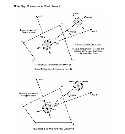

The snip below ( sign convention for shell elements ) explain the membrane stresses and bending forces..
- f11, f22 , f12 modifiers are equivalent to modification factors on the thickness of the shell element.
- m11, m22 and m12 modifiers are essentially equivalent to modification factors on the t**3 of the shell element.
- ACI 318 suggests property modifiers for Walls Uncracked 0.70Ig , Cracked 0.35Ig but 1.0Ag for axial deformations..
- IMO, for uncracked 0.70Ig , and for Cracked 0.35Ig for f11, f22 , f12 modifiers literally means axial shortening and displacement incompatibility with adjacent frame columns..
- ACI commentary R6.6.3.1.1 (...... If the factored moments and shears from an analysis based on the moment of inertia of a wall, taken equal to 0.70Ig,indicate that the wall will crack in flexure, based on the modulus of rupture, the analysis should be repeated with I = 0.35Ig in those stories where cracking is predicted using factored loads )..IMO, implicitly restricts the use of proposed modifiers 0.70Ig,0.35Ig for the analysis based on the moment of inertia
- I will suggest you to look also to the tutorials ..
