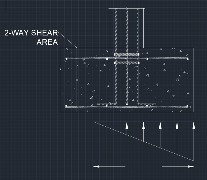

Okay, at long last, I think that I understand your concern: uplift at the soil / footing interface, not uplift at the column footing interface (what I was getting at in the other thread). If you post a cross section FBD of the footing, I may be able to speak to your particular concern.
Sure, here is a rough example of the concept. This is not a particular footing I am designing, this is just an attempt to approach the problem rationally. If it makes it easier and you would like me to come up with footing dimensions and loads that would fit this problem, just let me know.

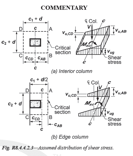

From the photo, we have a bending moment induced left-to-right, causing a zero pressure location within the 2-way shear area per ACI code. This, to me, invalidates 2-way shear, unless we try to justify 2-way shear as acting on only 3 planes within the footing, rather than 4 (similar to edge columns, see ACI example below). Therefore, I propose using STM to determine validity of the footing instead of relying on section analysis that may not be appropriate for the design.
Is there something fundamentally invalid or incorrect with using STM rather than a 2-way shear check? Alternatively, is a 2-way shear check a reasonable approach when the footing sees a load reversal within the 2-way shear area?
As you surely know, most of what we know about punching shear comes from thinking about, and testing, elevated slab to column joints. In that space, it is common not to count the exterior side of the punching perimeter as contributing unless the slab extends, say, 5X the slab thickness from the column face. That would seem to speak to a similar concern to yours and it's curious that we don't seem to apply similar logic to footings. None of this has anything to do with the nature of the soil stress however.
It may be useful to remind yourself that the punching shear failure frustum is primarily supported not by the soil but, rather, by the surrounding concrete via diagonal tension resistance. Since you still have surrounding concrete on four sides, a four sided punching shear perimeter is still reasonable. You know, excepting the 5X stuff that I mentioned above.

Making the footing wider increases the loading area for the factored loads (which then causes the slope of the soil pressure distribution to decrease). Because the soil load slope decreases in magnitude, if we make the footing wider with a given column compression force and moment, the location of zero pressure will move outside of the 2-way shear perimeter.
Given Q = 5000lbs, M = 10000 ft-lbs, and the footing is 4ft by 4ft, we get:
P0 = Q/A - 6M/BD^2 -> 5000/16 - (6*10000)/64
P0 = -625psf
P1 = Q/A + 6M/BD^2 -> 5000/16 + (6*10000)/64
P1 = 1250psf
If we assume a linear pressure distribution from the left side of the footing to the right side, we get a location of zero pressure at x = 1.333ft from the left edge of the footing. [y = 468.75(x) - 625]
If instead, we size the footing as 4ft deep by 10ft wide we get the following:
P0 = -25psf
P1 = 275psf
Linear pressure distribution is [y = 30(x) - 25] with a zero pressure location at 0.833ft, shifting the zero pressure location further away from the footing centroid, and thus, further away from the the 2-way shear boundary area.
