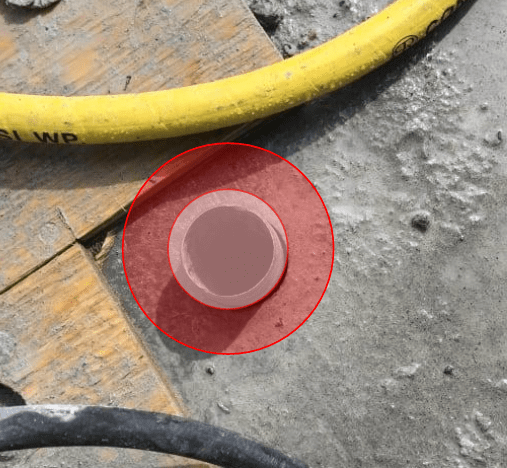

If the hydraulic jack loads the concrete around the perimeter of the core hole (see photo below) the concrete will be 'confined' and there will be NO cone break-out.
Assuming you have a hollow jack, and in that size, and compact enough, then it would be confined. If you use a welded beam with compact jacks under each end then it might not be.
What I have done in the past is to fabricate a custom steel stool/chair with annular bearing plate (slightly larger than the hole OD), and welded a threaded rod to the stuck bit, and a 5-ton center hole ram to pull the bit out. Concrete is confined, no cone failure.
