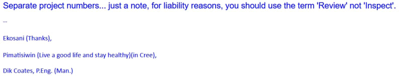

I always use 'reviewed' in lieu of 'approved' and 'inspected', and 'released' instead of 'issued'.
Dik, I was going to make the same comment.
I haven't spent much time in Procore, but my entire career it's been drilled in to me that I should never "approve" a shop drawing, "Reviewed" is the best I can offer.
Has anybody chatted with their lawyer about how to address the problem within the confines of Procore?
Great points, that has always bothered me about Procore. Our lawyer has always said to avoid the word approve, but Procore doesn't give a lot of options.
part of an eMail to one of my clients a week ago... He sent two similar projects and I let him know that I would be treating these as two different projects.
