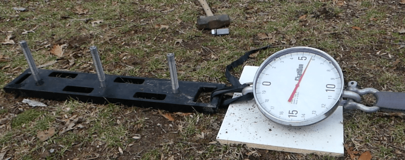

Disclaimer: I'm a fireman with access to a machine shop. I have a good general understanding of materials but I'm far from an engineer.
I have been manufacturing pickets (or stakes) that get driven into the ground via a striking cap and sledge hammer. The ends of the pickets are machined (one end to a point and the other turned with threads to accept the striking cap.) I'm running into issues with the cost of 17-4PH H900 and was wondering if there was a similar metal that would take the impacts of striking without breaking the bank. I've experimented with 4140 before, but the pickets are 42" long and we had issues with the stock warping during the heat treat process. Any help would be greatly appreciated.
The obvious difference between 17-4PH and 4140 is that 17-4PH is corrosion resistant and 4140 is not.
If a non-corrosion resistant alloy steel like 4140 is acceptable, then take a look at ETD 150. It is a 41XX alloy steel that develops its strength (150ksi uts) during the drawing process, so it does not require secondary heat treatment. It machines well and the as-drawn bar stock has good straightness. As for whether it has adequate strength for your application, I can't say based on the limited information provided in your OP. Definitely lower strength than 17-4PH H900 (190ksi uts).

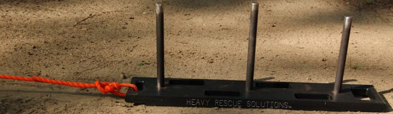

I do need some corrosion resistance as it is an exterior application. The pickets are 1” outside diameter and they pass through a 1.5” thick anodized aluminum plate with three 1.007 bores (one picket in each hole) in it and go into the ground for a short amount of time (<2hrs.) This creates an anchor anywhere the pickets can be driven. A load of up to 10,000 lbs is imparted to the plate as long as the soil will hold.
JHurley32,
From your last post it doesn't appear that the working stress levels in your pickets are that high. However, it would be helpful if you could provide a simple sketch of your picket, and also a diagram of how loads are applied from the plate to the pickets. The only exception I can think of is high local stresses in the threaded connection between the picket body and striking cap produced by sledge hammer impacts. But this condition can likely be resolved by modifying the joint design.
You noted that a corrosion resistant material is required for the pickets, and since it appears the service stress levels may not be that high, you might consider using a more economical grade of stainless steel such as cold drawn 303S/303Se Gr. B (115ksi uts) round bar. It will have the diameter/straightness tolerance you require in the as-drawn condition, it machines easily, and will resist galling at the striker cap thread connection.

The stresses on the picket are two-fold and very different. Initially the striking cap is threaded onto the picket (the picket has 1"-8 threads on the top 6" which aren't shown on the pictures here) and the picket, which is 42" long, is driven ~36" into the ground. All three pickets are driven through the plate and are in line. The load is applied to the plate, in-line with the pickets. The three pickets immediately engage with the plate due to the tight tolerance.

Having to drive and remove three stakes at once causes a number of problems. I think a more robust design would be stakes with a double head design that can be driven one at a time though holes in your plate, as DAVIDSTECKER suggests. You cannot compete with the cost and availability of commercial, off-the-shelf stakes. Keeping carbon steel stakes oiled can prevent most of the rust issue.
The stakes are driven in one at a time and removed one at a time.
