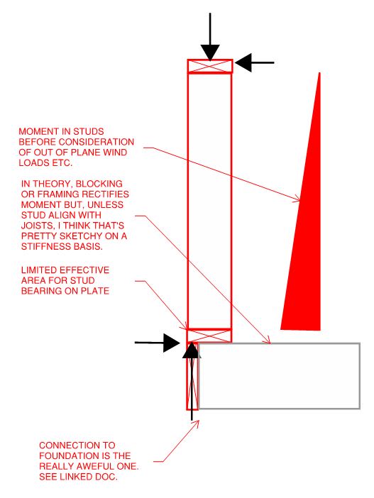

op said:
But 6'' wall on 2'' rim joist, with two stories' weight above, it doesn't make sense if you think about it.
I agree in some respects, as shown below. If I were to design a wood building without ever having seen one before, I probably would be inclined ot use at least a 3" rim member. The one that really bothers a lot of us is the platform to basement wall connection: Link
I always demand blocking in this case. We also need it in order to install shear brackets between wall and floor.
Stupid IRC still just calls for anchor bolts at 6ft oc, and the rim joist to sill plate with toenails 6in oc, joists to sill plate with 3 toenails.
Tops of basement walls detached from the floor diaphragm (leaning in) is not rare.
