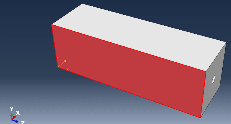

Also here is how I defined the surface:
myModel.parts['Part'].Surface(name='LoadSurface', side1Faces=myModel.parts['Part'].faces.findAt(((0,h/2,b/2), )))
To ensure that the surface is defined properly you can enter this in CLI (Command Line Interface in Abaqus/CAE) and then highlight the newly created surface in viewport.
This is what I get and this is exactly the surface where I need the shear to be !

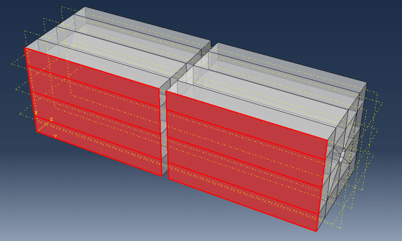

Also, I partition and make holes in the part after this. So finally, the part should look at this:
So it seems my part is consituted of many shell elements. But it wasn't a problem until I used this command
