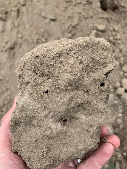

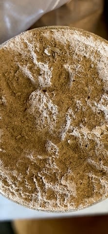

Generally the collapse prone soils in my area are relatively dry (or commonly referred to as "slightly moist" in my region) clays and silts. The soil will have "pinhole" or "porous" structuring where the voids in the soil will close up, densifying the stratum, upon wetting under a constant load. Typically you can tell before even opening a California sample liner because it's significantly lighter in weight (DD around 70-90 pcf with a MC around 4-8%) than a normal soil sample. Sometimes you have to look closely at the sample to see the holes, other times its very obvious, more like pencil holes.
Pencil Holes:
Pinholes:
