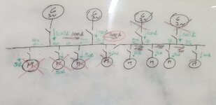

Hello,
imagine to have a switchgear with a double busbar and a bus tie NC. Connected to it, there are 4 generators each capable of generating 100 amps, working in parallel, and 8 motors whose FLC is 50A. In normal condition every section of the busbar is crossed maximum from 50A (in green in the attached picture); in worst case scenario, i.e. all generators on one side and all the loads on the other side, the maximum current that crosses a busbar section is 200A. So to me looks reasonable that this should be the sizing current; instead, normally the busbars are sized on the sum of the loads (+ a spare %) or the sum of the generators' currents. Is there any standards reference for this? What is your opinion?

Hello, thanks for your contribution. Yes, probably some switchgear manufacturer would be the more indicated person.
By the way, the main bus can handle all the load; the point is that with several generators in parallel, whatever section of the bus bars you consider, it will never be crossed from the current correspondent to the full load.
If instead you have 2 transformers and a tie breaker NO, with the 2 transformer normally working at 50%, you may have only one transformer available and the tie breaker closed, so in that case the current in the bus bar section close to the incomer will be almost the one correspondant to the full load.
We could deduct that the correct sizing corresponds anyway to the power available on half bus bar.

I don't know of any rule that requires the main busbar to be greater than the sum of the loads. I often see switchgear where the loads are greater than the bus size, these system often have backup equipment such that all loads don't all operate at the same time. I've also seen main-tie-main systems where each side had close to the rated bus current connected, meaning the total load could well exceed the bus rating if run through the tie switch.

Thank you all for all the replies, I will be more specific, it's not theoretical, it was an example suitable for several cases. In this one, I have to make a preliminary study to get a budgetary quotation for a new plant that will receive power on a new 11 kV SWGR with Busbar A-Bus tie-Busbar B from 4 power lines, 2 on busbar A and 2 on busbar B. These 4 lines are synchronized. Incomers are 630A rated and there are several loads. My point is: normal practice would suggest to size the busbars 2500A, but as in worst case the maximum current that will flow in whatever section of the busbars is when you have all power on one side and all loads on the other side, I am considering to size them 1250A so saving money. I was wondering if someone has experience on this - thanks Lionel - and if there is some Standard prescription. Maybe in the NEC - thanks waross - there is something but for Low Voltage, if I recall correctly.
