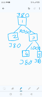

I need some assistance.
I have a step up stepdown system to get power from my power source to my irrigation lands throughout my farm.
We only have solar power so fact being at night time the transformer’s no load current use about 10% of my batteries.
I want to switch the transformers off in the evenings and on in the mornings but the problem is the inrush current every time I switch on the transformers the inrush current trips the main breaker due to the high inrush.
I need something to start and stop the transformers without that inrush current.
My setup is as follows.
Transformer 1:
Step up
125kva
Primary 380v
Secondary 3000v
Transformer 2
Step down
100kva
Primary 3000v
Secondary 380v
Connected to Transformer’s 1 secondary
Transformer 3
Step down
50kva
Primary 3000v
Secondary 1000v
Also Connected to Transformer’s 1 secondary
Transformer 4
Step down
25kva
Primary 1000v
Secondary 380v
Connected to Transformer’s 3 secondary
Transformer 5
Step down
10kva
Primary 1000v
Secondary 380v
Also Connected to Transformer’s 3 secondary
I only want to switch on and of the main step up transformer.
Can you please assist me.

Could you post a single line diagram of your system?
More information yields better answers.

Its a old system and its working fine no problems I just need something to switch it on in the morning and of in the evening because the no load is using to much of my batteries at night time.
No I start the transformers and then after a few minutes I start the loads running from the transformers.

Lionel, if I understand it correctly from what the OP has written, this is an isolated and off-grid location.
1. Just curious, why would transformer's no load current consume 10% of battery power? No load current of any transformer should be below 1-2% of rated current. Introducing more circuitry will result in wasting more energy.
2. I would use magnetic contactors and timers so that after I energize the main transformer, every transformer under it would turn on at least 10 second later. This way you can nullify the impact of sympathetic inrush and starting current of pump motors. You can also use star-delta or soft starters(based on pump rating or how much you are willing to spend) to reduce starting torque.

You really need to do a full end to end check of this system to see where your perceived energy loss is actually occurring.
My suspicion is that your invertor is eating a fair bit of that overnight current and it actually doesn't make a difference about the TXs, but then I'm not sure if you've tried this already and it is in fact the TX's or not??
Have you tried disconnecting the output from TX 1 then switching it on then switching on no 2, then no 3?
Would this be within the range of your breaker?
