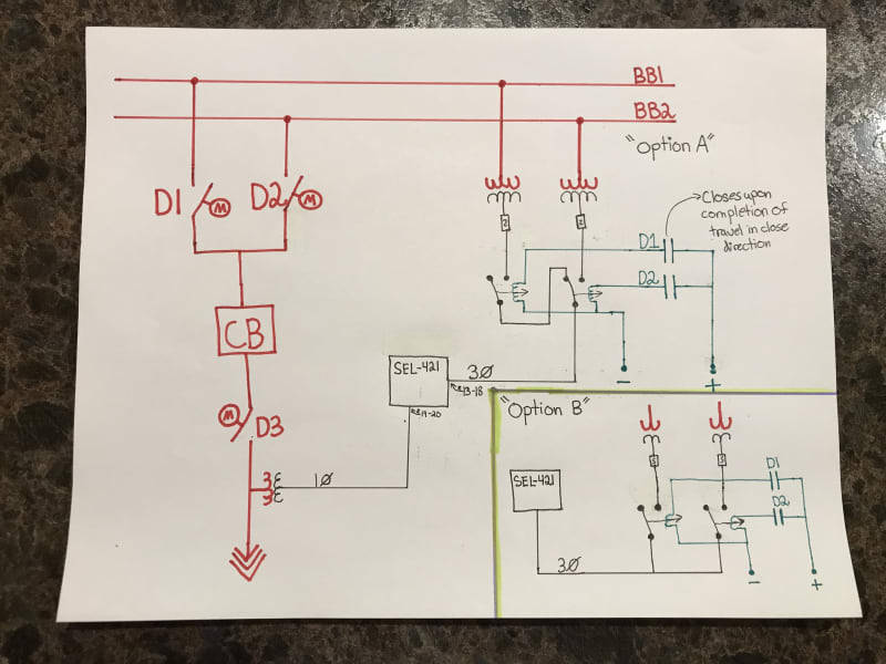

For switching analog potential inputs via auxiliary relays, would option A or option B go into practice? Why or why not so?
When a 421 or 311C looses voltage inputs for a few milliseconds, how long does it take for the relay to recover with and without LOP enabled?
If I was to place re-closing and sync check away from the relay in question and use VAZ, VBZ, VCZ (terminals 19-24) for my second voltage input could I configure the relay to "select" analog values based on MOD (open/close) aux contact inputs? And do this seamlessly (without dropping 21p/g protection) when switching between busbars? Could I use freeform logic to configure the relay such for the loss of a normally selected voltage input the relay would automatically select the other provided an input told it the bus coupler and its associated disconnects are closed?
I wish SEL would make a relay with more voltage inputs along with the required logic required with such schemes. My only gripe, other than that I love SEL. :)
Take your voltage signal from the input of the CB.
That will be more dependable than switching inputs.
Ride through?
Use the limit switches to inhibit a trip if neither D1 nor D2 are closed.

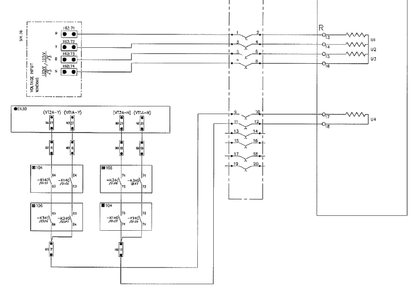

Its pretty easy to switch SEL 400 series voltage inputs. is an example of metering. I believe its a 4-8 cycle delay between switching (different parts of the manual say different times).
Some older distribution stations in my area utilize a similar Aux relay scheme to transfer voltages (xfmr side) on a M-T-M for SCADA metering.
IIRC the internal LOP delay is 15 cycles.
@Waross: 3 CCVTs on the outgoing line? You're to practical! [bigsmile] I was hoping to avoid SOTF, but, that might be a much better alternative.
Will the 421/311C automatically know which bus to draw its sync/reclose voltage from?
@Thermonic1: Thanks! I just looked, LOP can indeed be used to switch over to the another set of 3 phase voltage inputs. I'll just have to take one extra copper input run through the aux of the bus coupler breaker and its discos into account.

Be aware the pickup and dropout times for contactors can be quite different. Depending the on the contactor, there could be some amount of contact bounce as well.

Ok, so I have this:
(Numbers are off, I am well aware that)
Step distance and directional over-current from the transmission line, sync and reclose from the busbar.
My question is, could I eliminate the aux relays and wire directly into the SEL relay? Do I need logic or will the relay "select" automatically?
