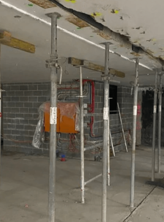

When I looked at this when it was in the press a few weeks back they had these whistle-blower photo from mid-May 2021:

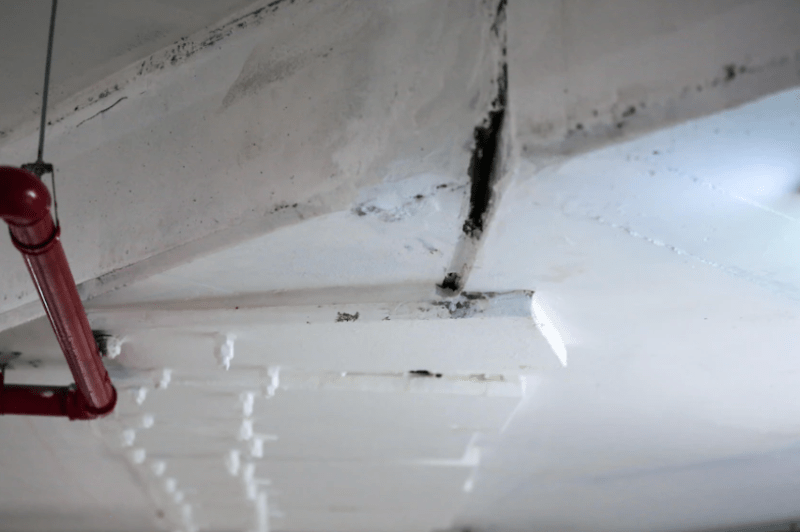

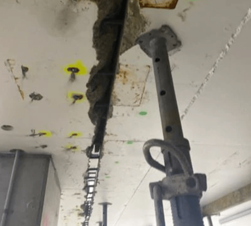

I assume the shored slab was intended to be supported by slab on the other side of the joint. There are cast-in plates visible on the shored-slab side soffit (see mill-scale etc).
Appears to be a permanent joint (in what is probably a post-tensioned, long-distance slab framing system), so either the design engineer intended for a dapped-joint (where each slab/beam is half-notched so one receives the other BUT this only works if the slabs/beams are of significant thickness to tolerate the half-thickness) OR the spans of the two slabs/beams in the direction parallel to the joint are dis-similar such that is significant resulting differential vertical displacement.
The plates are an attempt to either structurally support the shored slab/beam to the side that is not shored OR a feeble attempt to preserve compatibility of vertical deflections across the joint whilst maintaining free movement (??) in the plan of the slab (hence why bolted connection on one side only). May work in theory - but not promising.
Those plates are bolted back some distance - possibly due to PT anchors close to the joint.
==> EDIT: Those post-installed bolts on the LHS are tiny compared to the plate thickness and the active lever-arm.
More questions than answers.
Guaranteed that the lawyers will win!
The plates sure look like a makeshift seat/corbel, presumably to bolster the shear capacity of the failing joint.
Also thought in the line vertical displacement compatibility. Just curious, how does inspections work with consultants in Australia?
Do the designers themselves inspect prior to casting? Or is sub contracted to a 3rd party?
