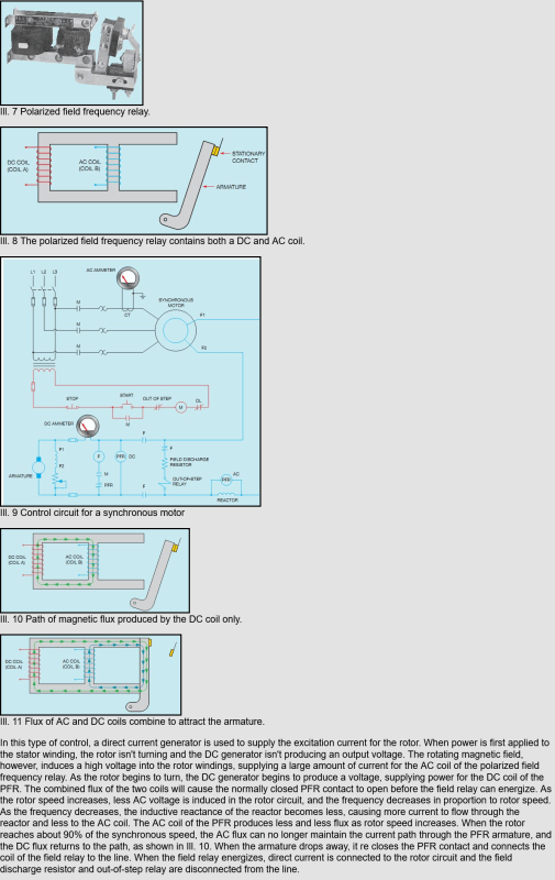

A sync check won't do the job.
Google "Polarized Field Frequency Relay"

rockman7892 There are three basic ways to start a synchronous motor. One is to undergo a "line start" - which is typically where the main breaker feeding the stator winding is closed and the machine comes up to near synchronous speed (as an induction machine) prior to engaging the main rotor field excitation. Another is to start the motor on a drive, which requires that the excitation be applied prior to closing the main breaker, because the synchronous rotor is intended to remain in synchronism throughout the acceleration to "normal" running speed.
The third option is to use a pony motor of some sort to spin up the synchronous rotor to near synchronous speed. At this point, close the main breaker to synchronize the stator with the main power supply. THEN close the contactor for the main field excitation (at full rated field current) to "lock" the synchronous motor into synchronism. And finally disengage the pony motor.

Your third method needs a Polarized Field Frequency or electronic equivalent to avoid damage.
The window of permission on a sync check relay may be too large for safely applying excitation.

My understanding, and have seen this before with large unbalanced voltages, is if the machine rotor is rotating relative to the grid magnetic field, it impresses an AC voltage on the field (a hard sync for example, or out of step) like an induction machine. The bridge will block one half of the AC wave. If the impressed voltage is high enough I could see that the reverse voltage could potentially exceed the breakdown voltage of the diode.
I haven’t done an exhaustive search but I’ve seen at least one brushless design where the manufacturer installed a surge arrestor on the rotating diode bridge to protect the diodes from overvoltage. The field relay waross mentions would be for this purpose. Static exciters pretty much always have a set of field surge arrestors.
Is it possible for a voltage transient from out of phase syncing (or any other voltage transient) to be reflected from the motors stator onto the rotating exciter?
Yes, it is. A slipped pole, for example, will cause the the field current to reverse.

From what I've read and understand the Polarized Field Frequency Relay (PFR) is needed in both applications for starting as an induction motor and starting with pony motor since in both cases motor will have stator windings energized and thus induce an AC voltage in rotor. The purpose of the PFR is to ensure that the AC field in rotor had diminished enough before applying DC field to rotor. Do I have that correct?

The field winding of a synchronous motor has an AC voltage that is inversely proportional to the motor speed while it is starting before the field is applied. The voltage can be very high if it's not clamped with some type of device, typically a resistor is used to keep it below the voltage ratings of the semiconductors in the exciter.

The PFR energizes the field when the slip and the rotor position relative to the rotating field are both suitable for smooth pull in to sync.
Brushless synchronous motors will have a rotating, electronic circuit to perform the same function.
This circuit, by whatever name, may have failed.

I might have seen 100 or more brushless motors by now that do not. They simply go brushless alternator - rectifier - field. When the exciter field is applied, whatever voltage gets generated is rectified and goes to motor field. The only control on the rotor is for the FDR or even just for SCRs to short the field opposite direction of the rectifier diodes.

Electric Machinery developed and held the patent on the first Polarized Field Frequency Relay.
The Sybc-Rite performs the same function on brushless synchronous motors.
