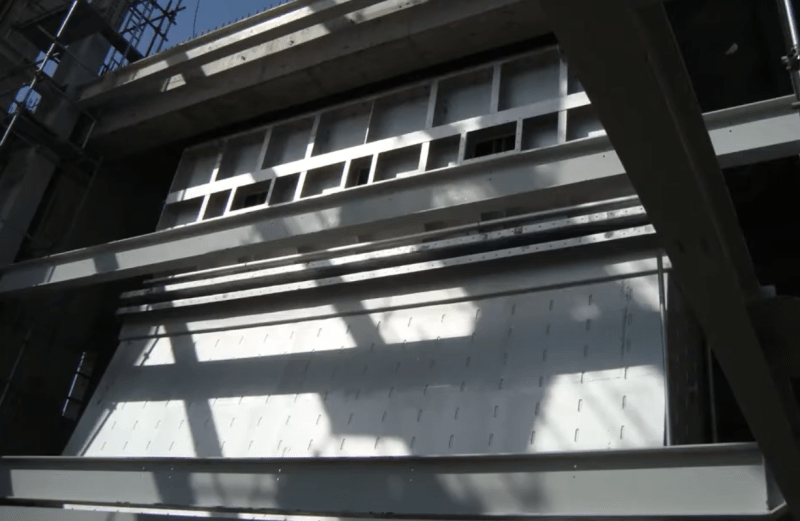

I found couple of examples where it seems that tab and slot joint was used for joining parts. This is water cooled structure (double wall) and from how many tabs there are used, I believe that those were not used only for alignment/fixture.
