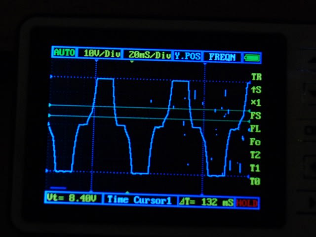

Agreed. There was a transformer as part of the filtering, but somehow it only worked when the generator was in Star. After rewiring the generator in Delta the transformer passed the noise. There's no reason I can understand for that, except if harmonics in Delta increased and the transformer passed some of them. All of the signals were tapped off of 1 AC line at a time (didn't matter which one) so it left me puzzled. This was long before I got an oscilloscope.

I'd have to see an actual waveform and how noisy it is, but... the easiest method would simply be to use a zero-crossing detector on a waveform that's suitably DC shifted. Even a very noisy waveform could be filtered with a cap/inductor to provide a clean enough waveform for average zero-crossings to provide a relatively accurate speed indicator. Forget the frequency-to-voltage converters... a simple op-amp could easily detect the zero crossings and provide a useful "click" for a micro to count.

On a delta you would have got a better signal going line to line.
Line to line has the possibility of moving the "noise" 30 degrees up on the waveform where it is less likely to cause false zero crossings.
A little load on the transformer secondary can help swamp out transients.

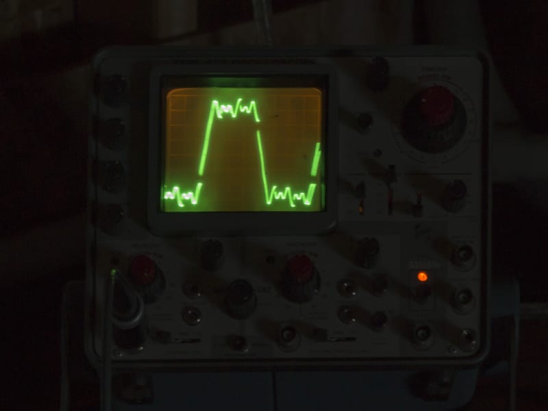

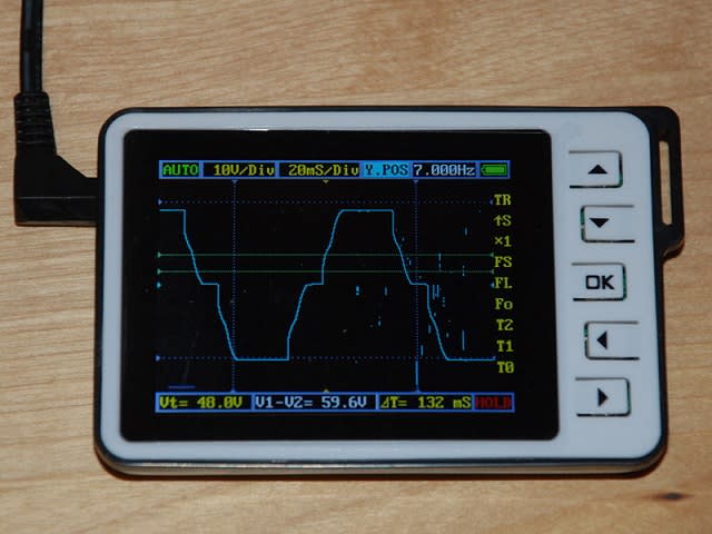

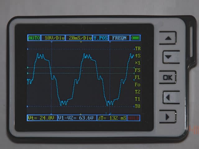

Here are some sample waveforms - different machines, different connections, different speeds, different loads so DO NOT compare.
It may be a 3 times or 6 times multiple of the base frequency Spar.
The actual multiplier is not as important as anticipating and looking for it, rather than discarding good data accidentally.

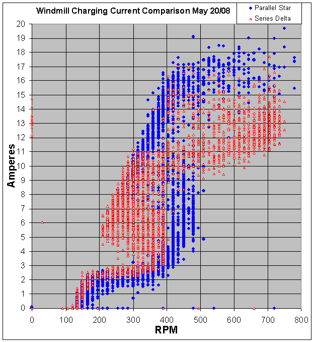

That circuit was probably fine for axial coreless alternators that some hobbyists build. My turbine itself was very different but robust (still running today) but there were consequences, like this data below. You can see how the range of scatter changes in Star and Delta.
