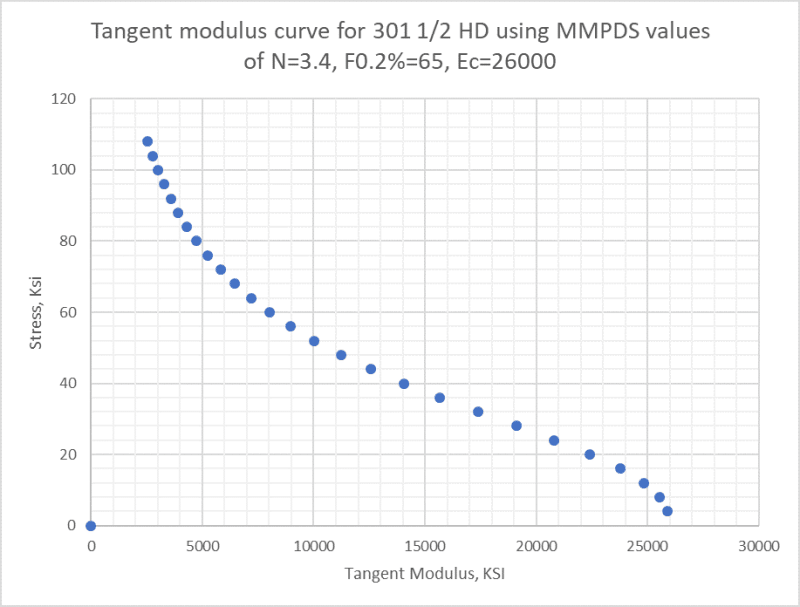

The real issue is that the two approaches differ by a lot.
Here is a graph I generated for 1/2 HD 301 in Longitudinal direction:

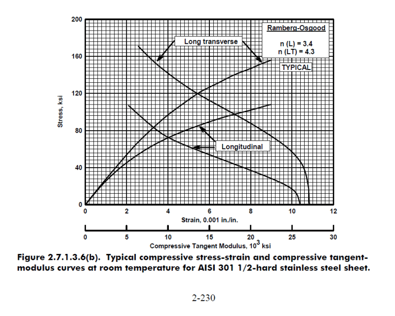

And the same curve from MMPDS page 2-230:
You can see for example that the tangent modulus I calculate for 80 ksi stress is just under 5000 ksi but looking at the MMPDS graph it is just under 10 000 ksi.
This is a large difference and makes a huge difference when I calculate buckling and crippling allowables...

your points look a lot like the L curve (with Ec = 26000ksi) …
From the LT curve, Ec = 27000ksi …

The data and curves in MMPDS are based on statistics, fairly large samples and rigorous analysis.
The values and curves are both reliable, but don't expect them to be identical.
After all the curves are related to a fit to the model, not exact physical measurements.
If you really want to know contact Battelle Columbus and talk to one of the MMPDS folks (such as Jana Rubadue).

Thank you for your input. I did contact Battelle and you are right, the stress strain and tangent modulus curves are generated using large sample statistical analysis and not the values listed in the standard such as the A, B or S basis values, which are less since they are based on different confidence levels. Battelle was actually really helpful to me when I called, hats off to them. They agreed with me that all the info required to reproduce the stress strain curves etc should be included and available for users of the MMPDS standard. I spoke with Carinne and she did not have an immediate record of the values used to generate the curves because they were extract from paper copies of the Data in the early 80's. She is investigating and will get back to me eventually.
