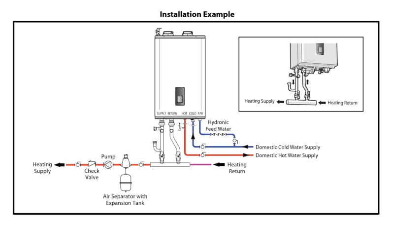

contact you plumber and JHA about the requirements to separate domestic hot water from a boiler loop. Need double-wall heat exchanger. No one wants to accidentally drink year old chemically treated heating loop water.
It is separate.
Seems like this would depend somewhat on the size of the dwelling as well as its location. in SF, a 1000-sf condo with single shower, dishwasher, and one washer/dryer, my son's, has the Navien NCB-180E installed IF TLDR, the heating is 80 kBTUh and water is 150 kBTUh
TTFN (ta ta for now)
I don't see an HX (and not and it needs to be double-wall). The very same water that goes into the coil, also will go into the domestic hot water. I don't know where you live, but that should be illegal in all areas that have decent plumbing codes. Once you make it legal, a separate boiler and water heater usually is better.
As for sizing, that depends on construction and the enclosure surface areas. Just floorspace is meaningless. Is the house a semi-sphere, or a complex zig-zag? Could be surface difference of 3 times. All window or wall? Extremely well insulated and low infiltration, or built like a card board box?
Probably also want a control to prioritize domestic hot water over heating for the time everyone has a shower.
You also need extremely good water treatment since those instant water heaters have very thin channels for the water. any tiny scaling, dirt or otherwise can clog them. They are supposed to be cleaned annually.
The HX is a hydronic air handler. Coil sits above the blower fan. Water comes in at 120 F exists 94 F (delta T = 26 F), which leads to 25,000 btu/h of supply at 2 GPM.

Not only do you have to maintain the potability of the water (during summer months when there is very little if any heating hot water demand), you may also have to comply with Lead Free requirements of all pipe/fittings/valves/equipment in contact with the water.
Correct, in summer the heating coil loop basically is a dead leg that will have NO chlorine or other disinfection.
You also introduce oxygen to the HVAC portion all the time. This is the opposite you want in an HVAC system.
That heater also has to be labelled as a "boiler" in a way that is acceptable to JHA. So many other red flags.....
Here a product actually designed for what you want to do, it has an HX (duh!).
In my jurisdiction a double-wall HX would be needed, so you should talk to your JHA if a single wall HX is acceptable. If they require one, you may talk to the manufacturer if they can fit it with one or if you need an external HX. A double-wall HX will be larger, so external may be required.
Please have it professionally designed and installed and approved by JHA. No one wants to drink boiler water and when the damage is done, non of the "people from the internet" that told you a regular water heater is fine will take the blame for you. When something goes wrong, you will be all alone....
Probably best to just show a typical installation; the only thing that the Navien combi-boiler heating loop shares with its DHW supply is the burner assembly and control circuitry. They have separate heat exchangers and the only potential issue is if you leave the makeup valve open, but that would be the same issue if you leave the makeup valve open in any hydronic system. The only way to get air into the heating loop is if you do a bad job of refilling after flushing.
There is oxygen in domestic water. and Chlorine. And I bet that Navien manual says somewhere that YOU have to consult local codes.
If you don't want to install per code, and just trust what you saw "Cousin Eddy" do 30 years ago, Go ahead.
If you want, just put two Navien heaters and a RPZ backflow upstream of the space heating unit to make that water non potable. Since it will be based on flow rate, it will be accurately sized and when the space heating is not used, the water heater will not be operating. Since it will be non potable, eventually all the oxygen and chlorine will not be an issue.
