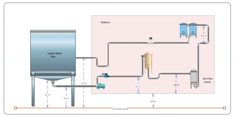

I want to modify an existing filter test setup with a 2 inch piping. The usual flow rates are 10 m3/hr and higher. To be able to test a different type of filter for which flow rates are quite low 1 -3 m3/hr on the same system I doubt that the pipes will remain full. The test fluid is water. Is there a way to calc. what is the minimum flow rate for the existing pipes to keep them full at all times?

A decent sketch and profile would be useful to see if you've got an issue or not.
The pipe empties the water back into the main tank (open) so forming a closed loop.

I have drawn the sketch and hopefully it gives you a clear idea of the layout.
The pipe elevations shown on the platform are measured w.r.t. the platform and thus those without any height are not elevated.

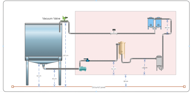

Ok, To make your system always full then simply make your last set of connections past the meter to include an inverted U bend, with the pipe higher than 110cm off the platform and insert a vacuum breaker on the high point. The route the down pipe in a continuous slope or flat into your tank ABOVE the water line in the tank.

But the high point downstream of the meter will mean that regardless of your flow rate, the pipes will always be full of liquid so long as you either vent the filters etc or flow at a high enough velocity initially to blow out all the air bubbles.

At its simplest a vacuum valve is just a bit of pipe open to atmosphere sticking vertically up for say 1m as the pressure drop in your last bit of pipe will be very low.
To incorporate both a u-bend and discharge of the return path, I am thinking of combining the two. Something like the following:
I suppose if the pump can cope with the increased discharge head, we can implement the setup without creating other problems. Do you see other potential issues?
Looks good to me.
If you want to ensure a full pipe at all times then something needs to change and this looks like a simple piping change to me.
