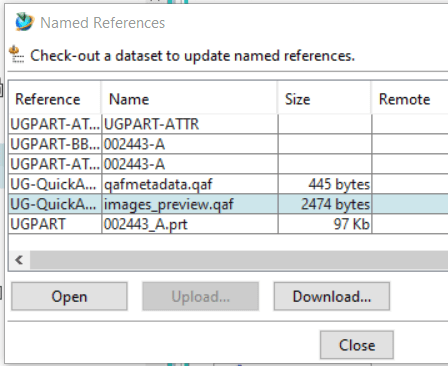

Does anybody know where the image in TeamCenter comes from ?
My issue is that I like to work in a darker background when in NX, but I would like my Teamcenter image to have a white background.
I see in NX there is a PART PREVIEW and a MODEL; VIEW PREVIEW, but I really don't know where each one is used so I can make this do what I want.
Jerry J.
UGV5-NX1899
The .qaf is either identical or very similar to a .jpg, you can load and modify as a .jpg.
( export the .qaf, rename to .jpg, edit , save and rename back to .qaf and finally re-import the qaf to Teamcenter.)
