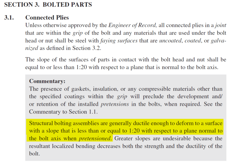

I think I found what I was looking for in RCSC Spec. It seems that gaskets would only be prohibited for pretentioned connections. But the commentary also mentions that deformed surface slope should be limited to 1:20 to avoid inducing localized bending stress in the bolt. So technically, I think if the gasket is thin and compresses such that the slope at connected plies is small, then I can treat this like any bolted connection without gaskets.
