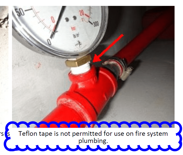

Dear Experts,
The above picture is from a site inspection report. Is it true?
Can anyone help me with any reference, please?
It's wrong. Somebody doesn't know what they are talking about.
We purchase Teflon tape by the case from Tyco and Viking supply net.
