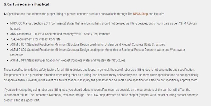

National Precast Concrete Association Q&A said:
Thomas writes:
Under what conditions can concrete reinforcing steel be used safely as lifting devices?
NPCA Technical Services engineers answered:
Use of rebar as lifting devices is not recommended. Lifting inserts used in precast concrete products must be verified for capacity and must have an adequate factor of safety for lifting and handling products. Safety factors include the various forces acting on the device, including form release suction, impact and the various positions of the product during handling. The capacity of commercial lifting devices must be marked on the devices or posted in production areas.
Lifting inserts, which are embedded or otherwise attached to precast concrete members, must be capable of supporting at least four times the maximum intended load applied or transmitted through them, as required in OSHA 29 CFR 1926.704 (c).
Lifting hardware such as slings, lift bars, chains, hooks, etc., must be verified for capacity and must have an adequate factor of safety for lifting and handling products. Lifting hardware must be capable of supporting at least five times the maximum intended load applied or transmitted to it, as required in OSHA 29 CFR 1926.704 (d).
Non-commercial lifting inserts and hardware must be proof-tested by a certified testing lab for the rated working load limit. OSHA requirements for lifting devices and apparatuses are documented in Title 29 of the Code of Federal Regulations.

I believe the other concerns raised are concerns about badly designed lifting loops, not directly about the use of rebar. Is that correct?
just call me Lo.
Lo,
I think you are right, the practice is not recommended, but apparently not "prohibited" by any code or regulations. I don't think the precasters would follow the call to use a hoop that is to be discard after a limited uses. However, the "ban" I mentioned had caused a rush to change our standard details for lifting device, instead of lifting ring, use metal insert and forged eye bolt with threaded end.
While this merely reiterates what has already been discussed, we all love an official-ish, published reference to point to. The clip below is taken from and can be found at: Link
