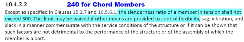

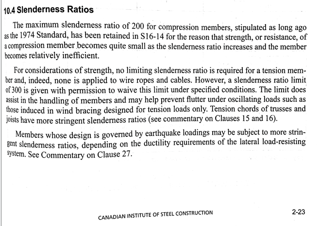

The commentary states:
Clause 15:
The K value would affect the "flutter", so it makes sense that it is included in the calculation.

AISC eliminated the member slenderness requirements for both tension and compression members, but retained them as "user's notes" and "guidelines"...largely because they have been used so much in the past and it's likely that as a fall back it has saved more than a few engineers' skins (whether they were aware of it or not). Note that I'm NOT referring to component slenderness to determine compactness for local buckling considerations.
But AISC looks at fabricated length because it's now primarily a constructability concern. Unless you're working with cable or wire rope, you expect the members to have enough rigidity to handle and put in place. If you exceed these limits, it starts getting difficult to handle the members and put them in place without them being damaged under their own self weight.
