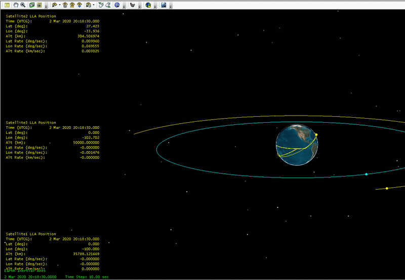

The simplest approach to estimating the velocity is to equate v^2 / (r_earth+alt) = g_earth * r_earth^2 / (r_earth+alt)^2, since the centripetal acceleration must equal the radial gravity in a stable orbit. This results in v^2 = g_earth * r_earth^2 / (r_earth+alt) As altitude increases, velocity decreases, which means that angular velocity likewise decreases; at the geostationary orbit altitude, the angular velocity difference between earth rotation and the satellite goes to zero, since that's essentially the definition of geostationary orbit. Therefore, beyond geostationary orbit altitude, the apparent angular velocity difference, i.e., how the satellite moves across the sky, must appear to be in the opposite direction relative to a low orbit satellite's motion. The bottom graphic shows the LLA displays for 3 satellites, one at 300-km altitude (LEO), one at geostationary, and one above that orbit. The lon(gitude) rate displays show a positive value for LEO, indicating that it's moving west to east, relative to the Earth, the geosync shows zero lon rate, as expected, and the higher orbit shows a negative lon rate, indicating that it will appear to be moving east to west from the Earth.

btrueblood said:
Higher velocity in higher orbits
Sorry for being a stick in the mud, but that doesn't work. Your velocity increase can be traded for higher potential energy, but not BOTH more potential energy AND kinetic energy at the same time. When stabilized at a higher orbit, your velocity is lower, not higher. Newton's law:
G*M = r * V^2
"G" and the mass of the Earth are constant, so every orbital radius is inversely proportional to velocity.
LEO is about 7,000 meters per second
GEO is about 3,075 meters per second
The confusion comes (in IRStuff's example) because to transfer (eg. Hohmann) you have to speed up first, to get to a higher orbit. But during the transfer you slow down.
Fair enough, I was thinking delta-V required, not orbital velocity.
