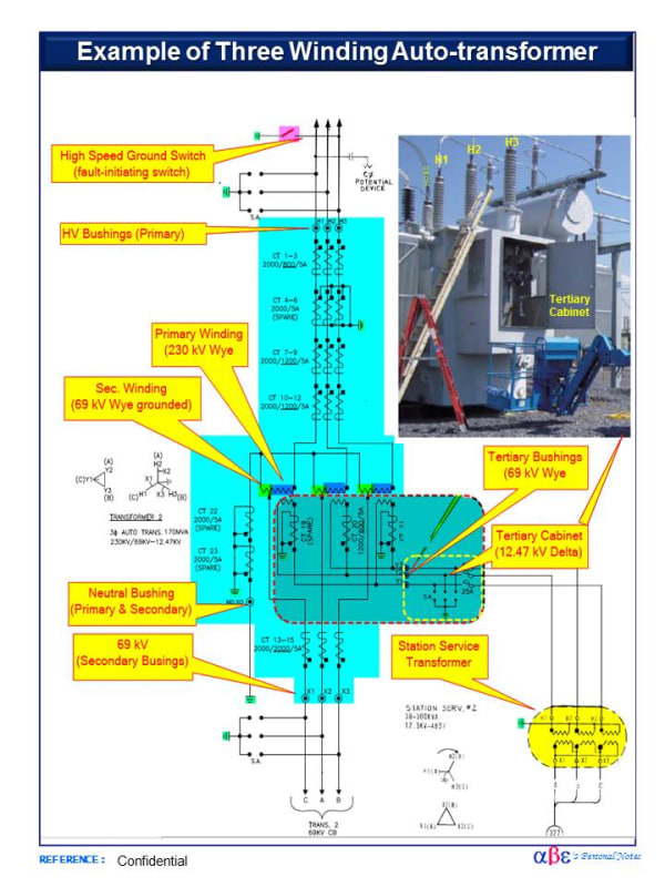

Mbrooke, the tertiary winding in those applications are feeding the substation MV auxiliary power.
Occasionally, some utilities choose feed 34.5 kV with overhead distribution/sub-transmission lines.
I see Auto's w/ Tert feeding 25-35kV Station power often. Nearly all of it is UG to 500-1500kVA Station service pad mount gear.

Our experience with voltage regulation on the tertiary winding is different particularly for existing old units in operation with LTC. Tertiary winding is usually designed to near 1/3 the total capacity of the main winding resulting in an oversize winding for the load connected. This winding not only helps to damps the effect of the third harmonic but also can effectively reduce the overall zero-sequence impedance and therefore alleviate the overvoltage problem during a ground fault.
There are no obvious benefits to operate unloaded the tertiary winding since will be a tendency to increase the temporary overvoltage (TOV) requiring to have one of the corner deltas permanently grounded. Otherwise, the full side surge arrester in the tertiary winding will be at high risk of failure with a potential thermal runaway situation that can no longer support even MCOV and will cause more damage than benefits.
I do not see a problem to recommend existing tertiary winding to supply station service load, capacitor, or reactive power control. However, caution should be exercised to provide large power blocks from the tertiary winding to compromise the system reliability. For a new transformer design, there are other options that should be explored.
