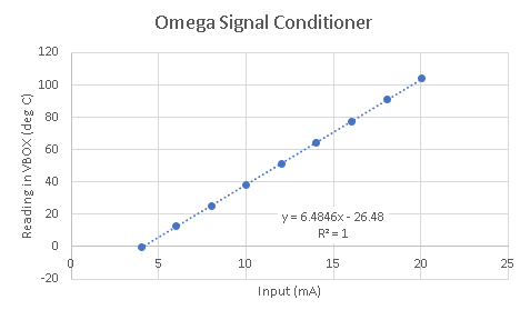

So when I manually input currents from 4-20 mA (using a 24v source and a 10k potentiometer) the readings in the VBOX look perfect.
So the temperature sensor and the signal conditioner both seem to work just fine independently, but when I connect them, it doesn't work.

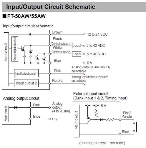

This is the sensor diagram
Sig + Pink
Sig - Blue
V+ Brown

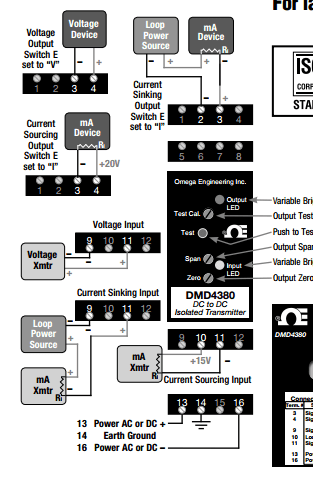

And this is the signal conditioner diagram:
I have it wired as follows:
9 Blue
10 Brown
11 Pink
I've played around with it a bit, but with no luck.
