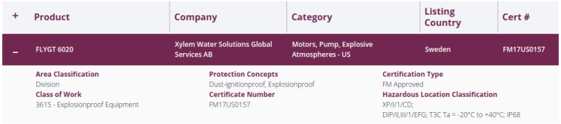

Example
Flygt sewage pumps are sold world wide. The type certification in the FM listing (below) is not useful in meeting IEC/EU requirements. This product also holds European certifications and a CE stamp, which I am not going to repeat here, the EU/IEC/CE approvals are not assured to satisfy codes requirements in the US.
