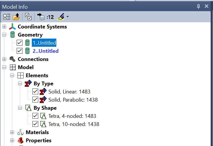

Jul 10, 2023 #3 TG_eng Mechanical Aug 18, 2017 83 0 6 US To figure out a specific element @rb1957 is correct. An additional way to get a quick understanding is too look in the Model Info Tree under Element Type / Shape. It will label the Linear/Parabolic or 4-noded/10-noded. Upvote 0 Downvote
