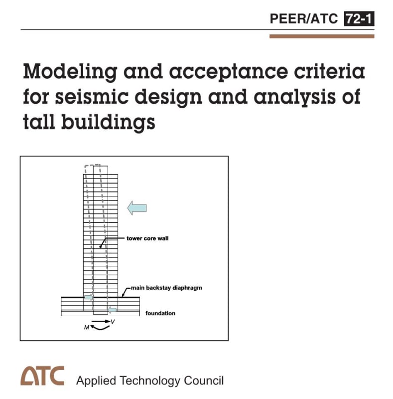

verycuriousengineer said:
I am also very curious to know if anyone has a recommendation about a textbook that explains the right way to model structures in softwares like Etabs or Staad Pro or Robot Structural Analysis with a step by step procedure to execute seismic designs.
Effective modelling is of topic of particular interest to me and I've made a point of collecting references that deal specifically with that. The first two shown below are the output of CSI & Bentley respectively and are marvelous places to start. That said, I don't know that they necessarily provide step by step guidance on software manipulation. And frankly, I wouldn't recommend that even if it were available. In my opinion, what you want is general, good practice strategies that are largely independent of the particular software that you choose to employ. The step by step stuff is the domain of the online help systems.

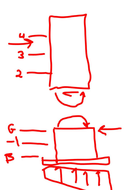

There's mention of backstay effect in NERHP Tech Briefs on Diaphragms, and also in the LATBSDC document. It is a real phenomenon that needs to be considered.
lexpatrie said:
On a related note, when did "backstay" become a recognized phenomenon?
I feel as though it started to gain traction in the 2000 - 2005 range. It's a case of it being something we didn't care about much when we didn't have the tools (FEM) to evaluate it expediently. Then, when FEM became ubiquitous, we decided to start caring a bunch. Prior to FEM, it was common to use very simplified models such as that shown below. Because such models resisted OT via base moment rather that diaphragm force couples, it made less sense to speak of a backstay effect which is in essence, a version of a propped cantilever.
