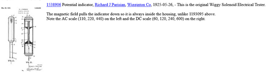

A modern high impedance Volt-meter will detect high voltages that the Old "Wigginton Voltage Tester" or "Wiggy" would swamp to zero.
It was a gross exaggeration to say that a Wiggy would dim the lights, but we said it anyway. grin.
Thank you waross. What is a Wigginton Voltage tester? Moving Iron meter?
The Wiggy was a solenoid type voltage tester.
It had both an AC and a DC scale.
It vibrated on AC and was steady on DC.
It had a window on the end with a pivoted magnet that would indicate DC polarity.
Screenshot 2025-05-26 at 09-36-42 Wigginton Voltage Tester — Robert's collection of antique sc...png
