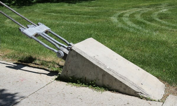

It looks to me like the break may have happened by pulling the cable out of a swaged fitting. There appears to be some deformation of the last few inches of the cable, and they remain tightly bundled, as if they were still compressed together. I suggest this would be the appearance of a cable end that pulled out of the fitting it was swaged into. The progress of that failure, beginning with perhaps some threads before others could then explain the unravelling of the rest of the cable.
BUT.
This cable construction is not a kind I'm used to working with. On aircraft, I work with stuff smaller than 1/2" so naturally this cable about 2" diameter is going to look different. It seems to have many counter-wound layers in it. The strands that seem to have failed are all in the outer layer. The next inner layer seems completely intact. Is that a clue to the mechanism of failure?
FYI: Swaging of fittings onto the ends of wire rope, like this type used in bridge anchors:
From the limited data available it looks more like a cable to fixture failure and not a cable failure per se.
Would need to see the other end to be sure and figure out what failed.
You can see what appears to be some material stuck to the wires at the end with the flat cut. This is likely the remains of the "spelter" used to anchor the wire to a Spelter Socket. Old school was to use Zinc as the spelter compound, In service inspection is nearly impossible.
Several standards require proof testing of spelter sockets at assembly to 2x or 2.5x, which is not possible if field assembled. See the attached crosby manual starting at page 58
The cable type is a type of strand. The lays in opposite directions indicate it is rotation resistant.
The guy here confirms - "It didn't really break it just kind of slipped out of it's socket...."
