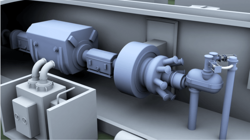

I think we're confusing different plants?
Tugs' image is from the vid in the linked article. It is from a plant in Alabama. The vid is dated 2015. Both plants seem to use gas turbines and burn fuel, so similar operations, I guess.
The Chinese plant described in the article "uses artificial air storage vessels" whatever that may be.
OTOH, the Hydrostor plant linked late in the article seems to use no fuel, expanding the compressed air only thru the turbine. Link is from 2021, wonder how it's coming along...
