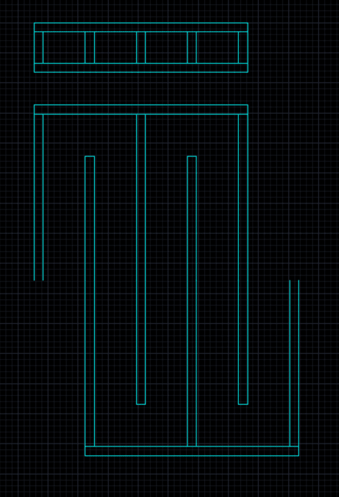

dhengr - not quite. Here's a quick sketch. It's fully enclosed, water flows in through pipes and out through pipes with these cooling channels in between. I'm certain that there is boiling going on in there, but that's not really intentional. Heat transfer mechanism is meant to be conduction from the steel outer plates to the water and then for the water to flow out to a discharge/capture/treatment.

Is one region of the large plate bathed in fire, or, is the heating of the plate fairly uniform?
I think rearranging the baffles so there is a "manifold" at each end, and each baffle forms passages that connects each manifold without wigglng back and forth might help.
Right now each slug of water that enters gets hotter and hotter as it passes over every inch of the hot plate, until it reaches the outlet. IF the plate in the last 1/3 of the travel is as hot as at the beginning, when the slug nears the exit it may be close to plate temperature and incapable of absorbing much more heat.

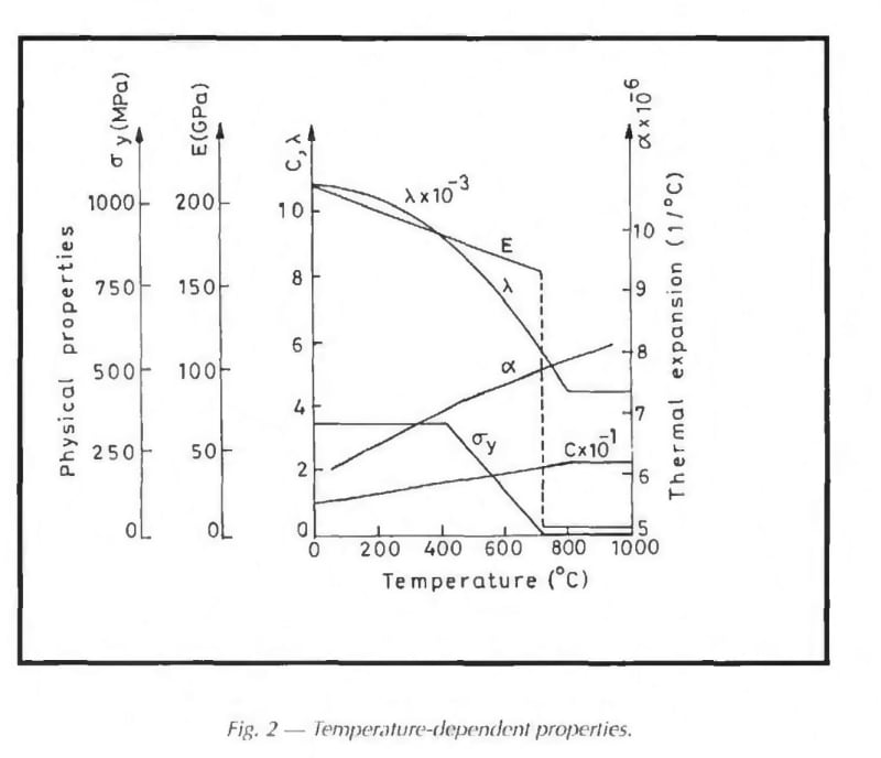

Actually I got confused with my units - the CTE of weld is approx 7E-6 per deg K (not per deg F). A36 is about 11E-6/K, which interestingly is quite a difference. Though if there was a significant CTE difference and it was a thing, I would have expected to have heard about it.
I expect the thermal gradient is so high that the resulting stresses are larger than the material can reasonably take.

Complicating this is that the properties of the materials are significantly different at the suggested temperature from their room temperature values.
