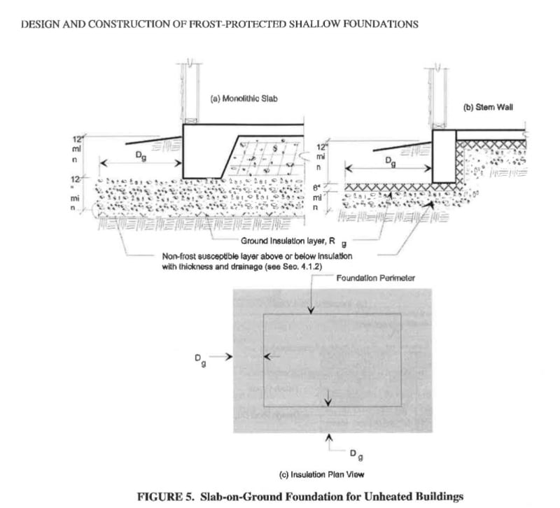

For an unheated garage built on a thickened edge in Canada we typically spec insulation under the garage slab (and out a few feet horizontally all around as well). We are basing our design off of a design guide called Frost Protected Shallow Foundations put out by the National Association of Home Builders. The theory is that if you insulated under the slab, the cold air wont be able to freeze the ground below the slab due to the heat in the ground. Also, according to part 9.12.2.2 of the National Building Code of Canada, the minimum depth of foundation containing no heated space must be below the depth of frost for silt and clay unless designed for lesser depths by a registered professional.
So I am wondering if this is standard practice for these slabs? I was talking to a contractor and I was told that they have never seen insulation required under a slab as we have spec'd. The garage is just large enough that it needs engineering, so its not very big, but I don't see how frost is being dealt with without the insulation in place.

The requirements you state are similar to code requirements in Alaska, that is foundations for unheated foundations are to extend to below design frost depth, unless soil in that zone is determined to be non-frost susceptible, or if ground is prevented from freezing through use of insulation.
ASCE 32 is the standard for determining insulation scheme, which is likely similar to the guide you refer to. Below is figure from that guide for unheated building. Dimensions for insulation are in a table, based on Freezing Index for the site.

The ASCE 32 insulations designs are based on thermal modeling, and are intended to prevent any frost penetration beyond the thin NFS layer below the insulation. The recommended footing depths/insulation schemes are not a function of local frost depths, they are a function of design Annual Freezing Index.
